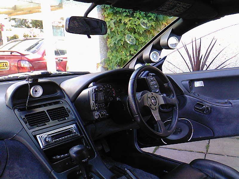

i have 6x9's in the doors really easy to fit too and not much bigger then stock speaker grills!
6x9 fit perfectly in the front doors, even follow the shape of the curve on the upholstered bit

There's enough room to do it although i would advise doing what i'm doing shortly which is mount some 5mm mdf onto the door and then screw the 6x9 and cover into that through the door card which then holds the door card tight to the door and eliminates any rattles or in my case fixes the broken plastic clips and holds everything tight
did'nt have any probs fitting mine allthough a little cutting was needed
