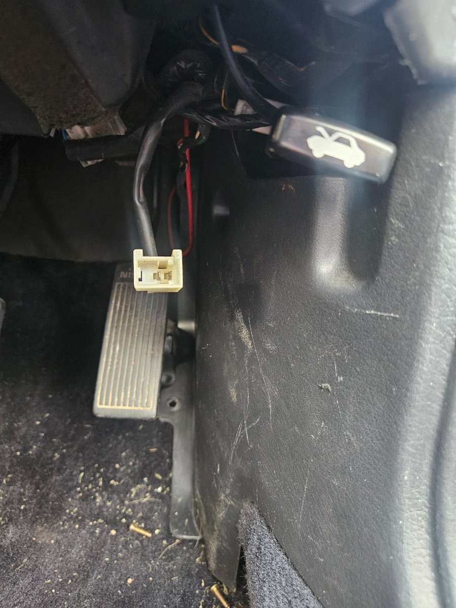

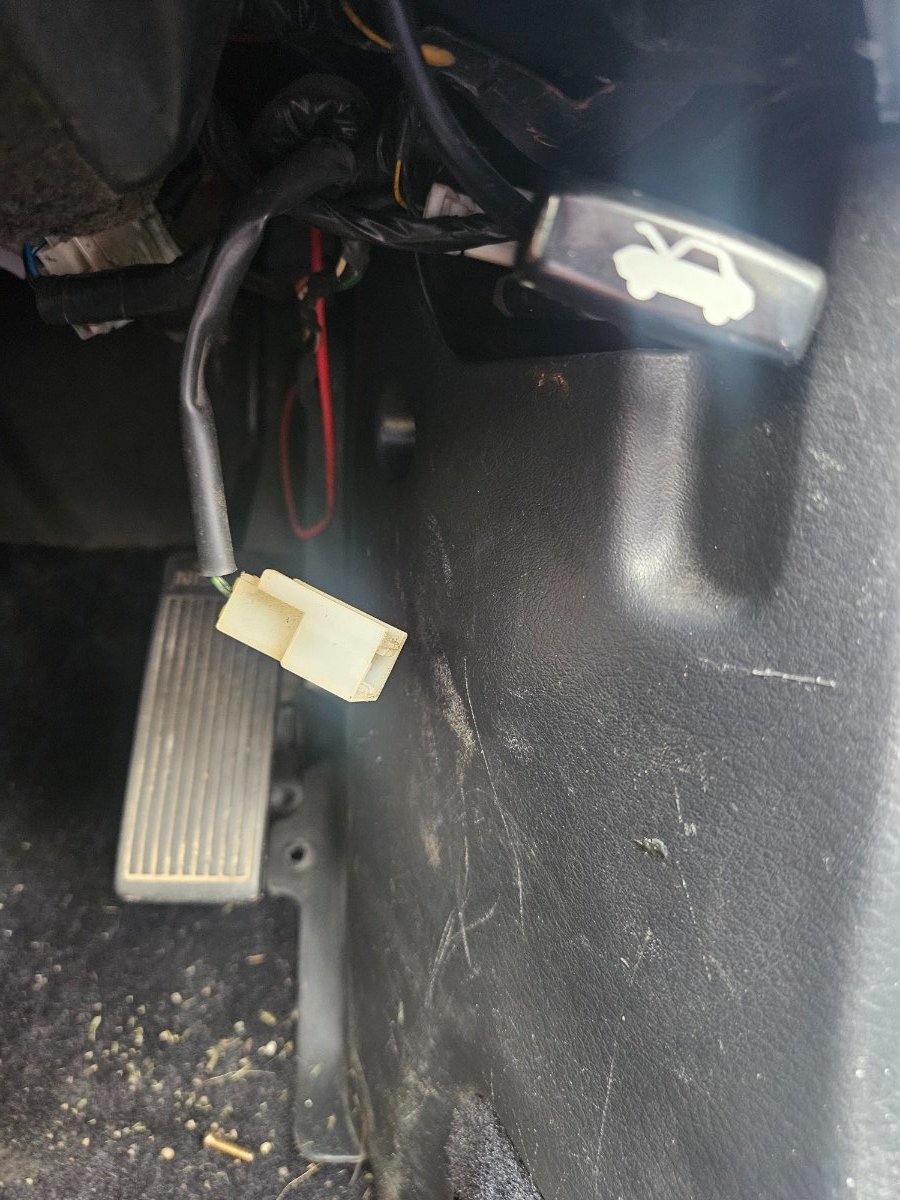

  10. Cheers for looking. I wonder if it's something the Nissan technician uses to plug something in? My cars been off the road for over 10 years. I was just about to put it through it's mot, when I realised the instrument cluster lights weren't working. I was hoping this plug was the answer, and i just needed to plug it in somewhere.
  11. Does anyone know what this connector is for that's dangling down in the drivers footwell?

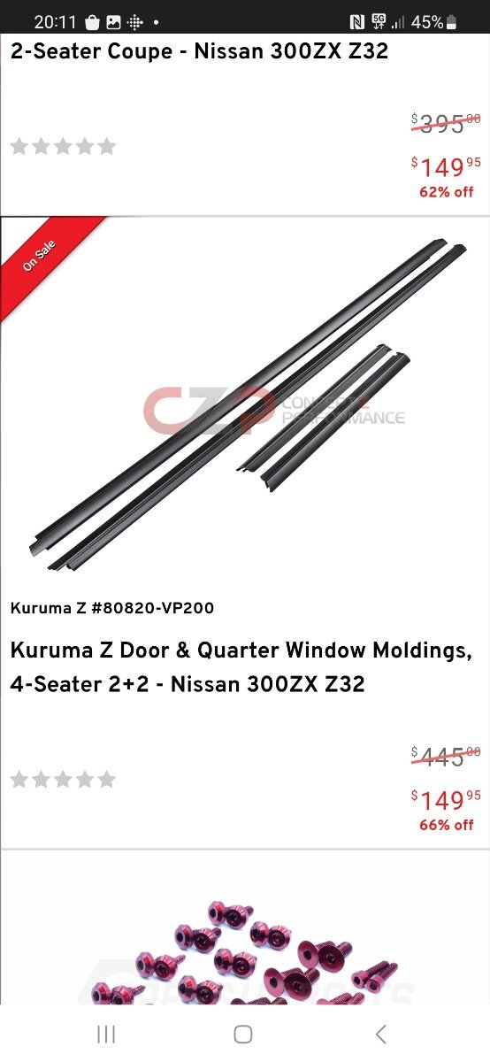

  16. As the title suggests, door and quarter window mouldings have 66% off at CZP. Cost just over £180 with delivery for both sides. Check out their other black Friday deals.

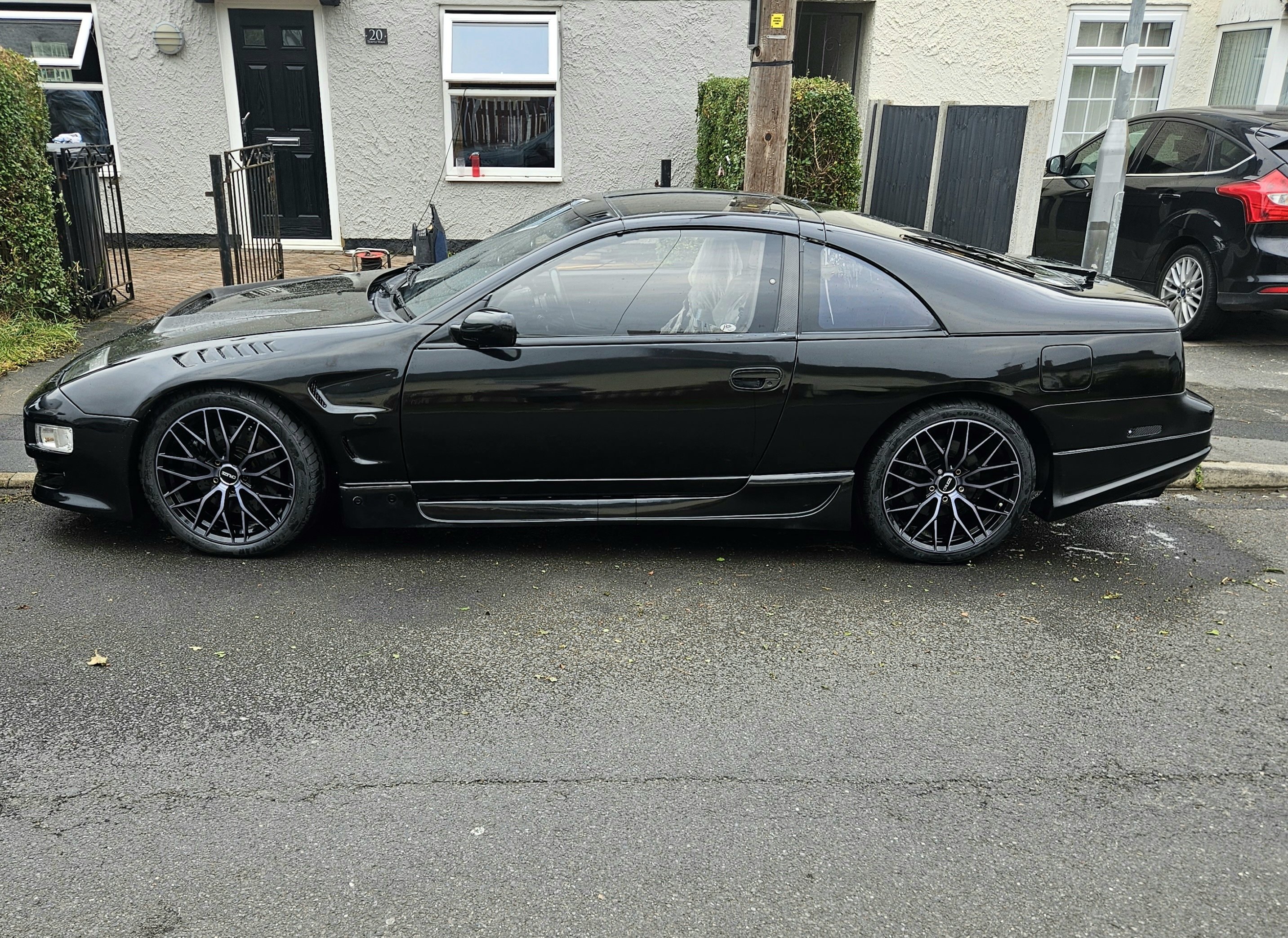

  17. As promised, pics of the new wheels. Not sure if i like them yet, it's so hard buying wheels without seeing them.on the car.
