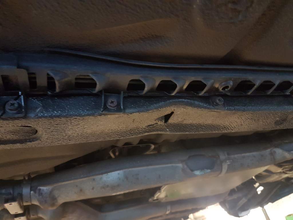

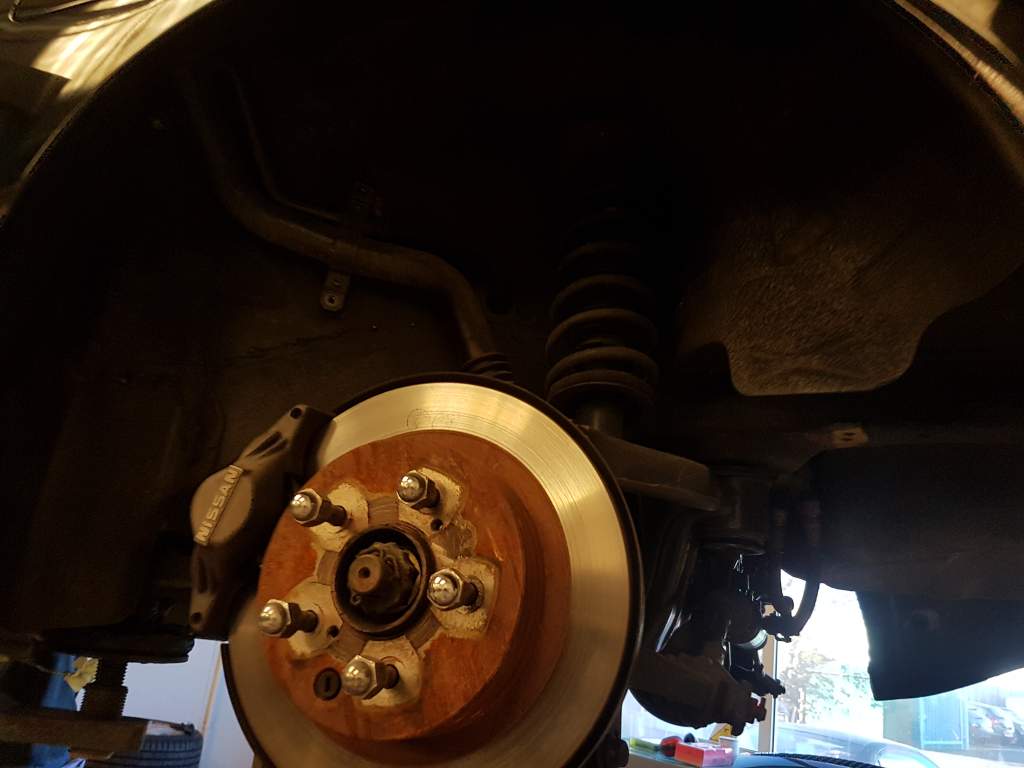

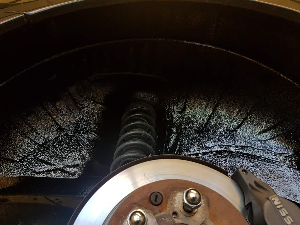

  4. Hi All, here are a few pics Ansons Autos sent me from the rail straightening and underseal. So just the rear spoiler to do and then I can start spending some money on more fun stuff!

  8. Gone in for a full 3m under seal and all box sections re waxed. I’m also having the lower wings straightened out and the rails knocked back into shapedue to some dubious jacking. As soon as my new spoiler arrives, that’s going on too, then a full clay and polish. Will look brand new in a couple of weeks! Was told it doesn’t need doing. So more reason to get it done me thinks! Sent from my iPhone using Tapatalk
