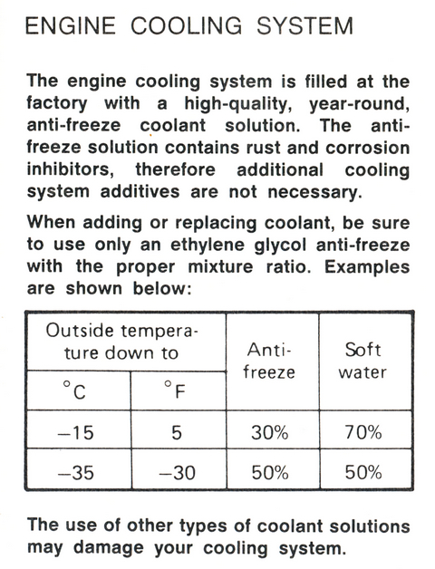

You don't have to go to 50/50 mix as I am being somewhat conservative! This is the relevant page from my
owner's manual.
Z32s use "Traditional" Inorganic Additive Technology (IAT) Ethylene Glycol base. In this country (winter) 50/50
mix with distilled water is satisfactory.
The product you have bought from Halfords is IAT antifreeze so is OK to use.
