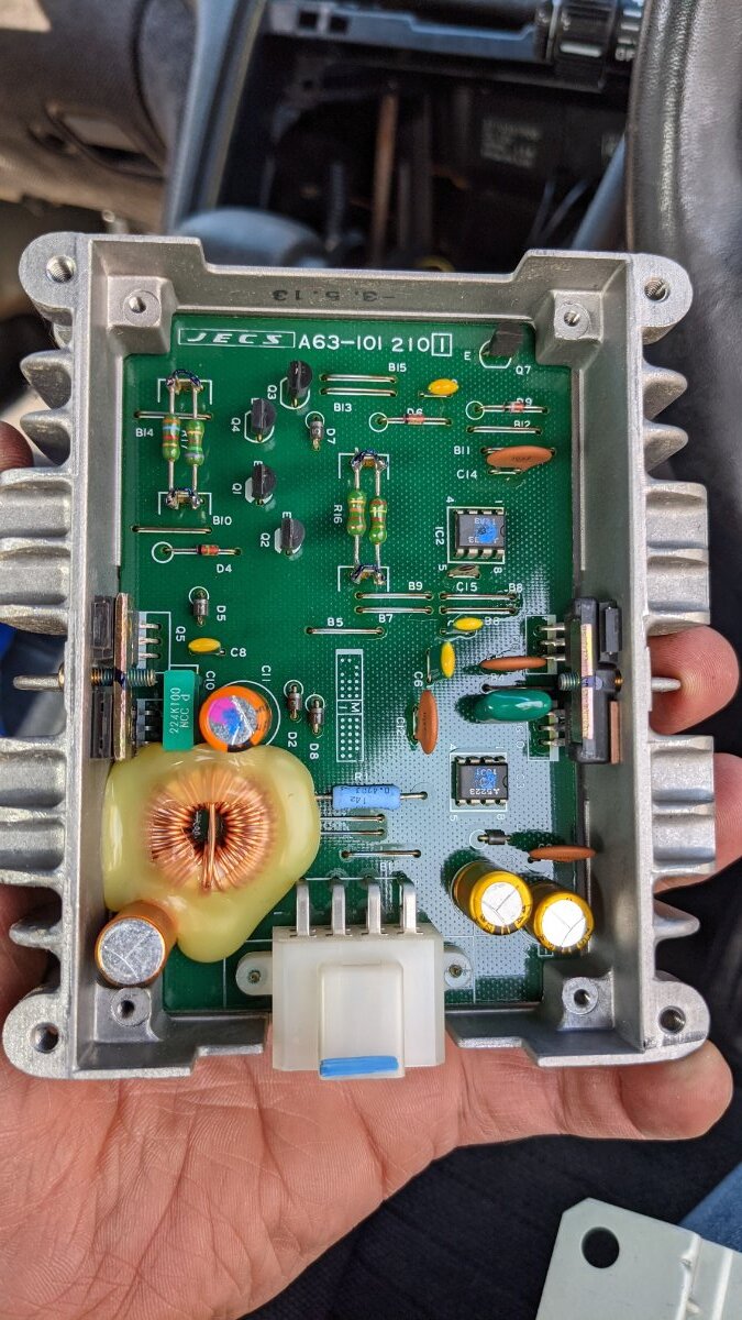

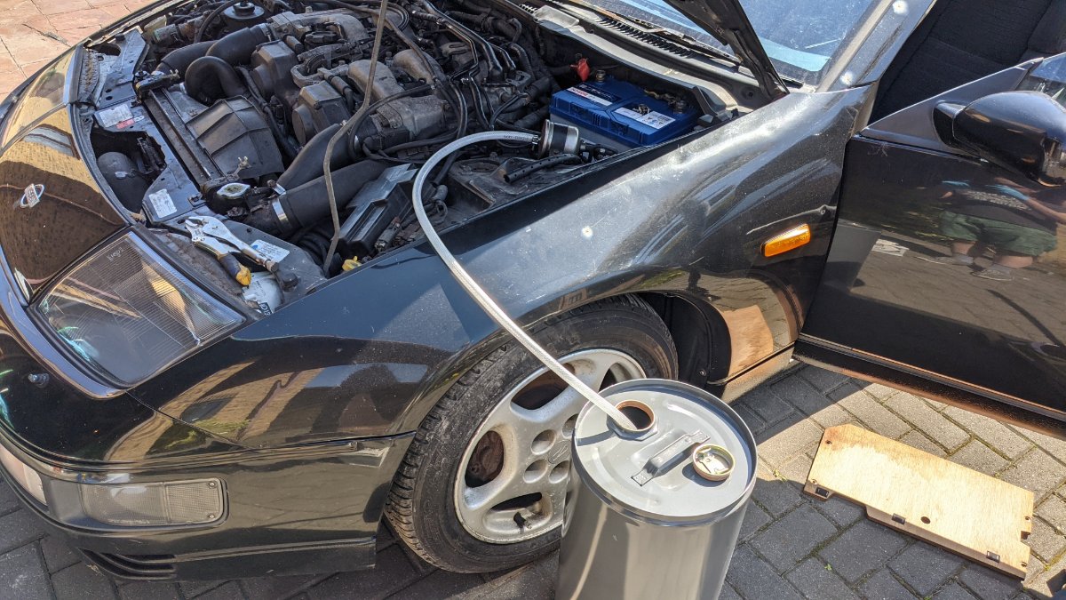

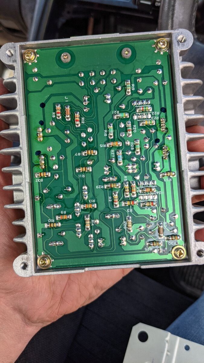

  4. Just a quick update. Completely removed the 90’s retrofitted immobiliser and repaired the splicings on the loom. I’ll get new immobiliser/alarm fitted at a later date. Disconnected the fuel line from the fuel filter, it was bone dry... Fitted a piece of pipe to go into a fuel can I was getting codes 11 (CAS) and 13 (Water Temp) Rotated the CAS and could hear the injectors clicking, the fan would run also due to 13. I’ve ordered a new Walbro GSS279 fuel pump, fuel tank o-ring and CAS connecter. Fuel pump relay is only momentarily energising at “ON” key position. Not when cranking. 12V momentarily seen at the fuel tank connecter Have tried PFCM bypass and still no fuel flow at all. Following this, https://conceptzperformance.com/wiki/index.php/Fuel_Pump Adam.
