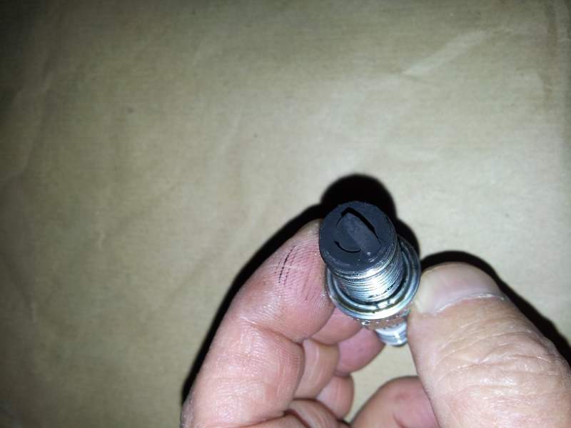

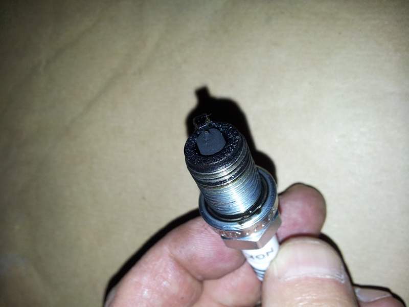

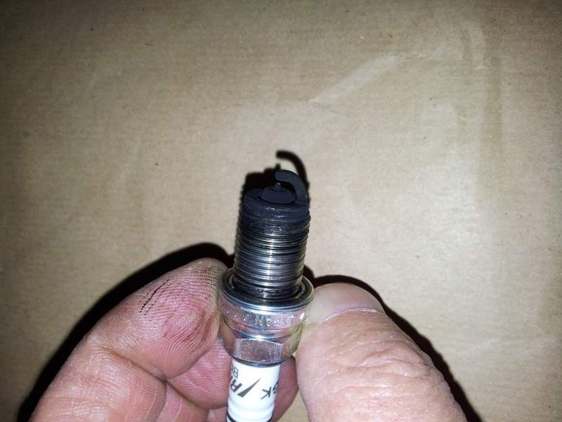

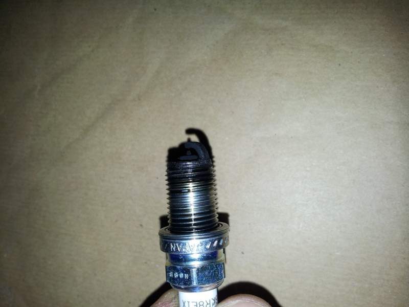

  11. OK! :thumbup1: Jaffa, you were right, asking a sparks plug change! Noz, I used BCR8ES and they run fine! Thanks guys!! I had a start test with four hands, and it runs nicely at 1000/1050 rpm with engine cold. No hesitations any more, and same vapor output from both exhausts until I stopped. Good, so the engine is now running fine for start and idle. Lambda values are around 12,5/13 By the way, is it possible to clean those fouled spark plugs and how? ... Or should they go direct in the bin? On the other hand, I had a lift on the 4 column lifter, and I could easily find the starter cable that I have to check. The view under the car was not impressive... as there is a number of areas where the rust has more than appeared! I'll target first the obligations for the french MOT, and get the registration. But then, I will need a better look and have some protection done.

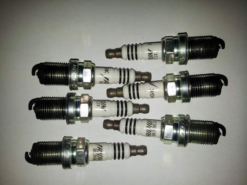

  13. Thanks for info guys! So, the matter was to find spark plugs in Reims today, and I could get 6 units BCR8ES (the BKR 7 EIX-11 are on order as not avaliable). I took some time to get the actual plugs out, and they are BKR8 EIX... black as if they stayed in a fuel chimney for years!! The pictures... They are all six the same. Not wet (they ran on Sunday for about 5 minutes around 1000 to 2000 rpm). I changed them for the ones I have BCR 8 ES gapped 0.9 mm. Before I try to restart, I would like your opinion. It looks like the fuel is much too high, at least for idle, and that's all the car has tried to run since Two years! However, when I started it on sunday, the AFR readings were not showing crazy numbers as they were around 11/14, and the garage was not filled with dark smoke. So could this come from multiple attempts to run it just warming up, without cleaning on the road? Maybe I should start and see how it runs with the new plugs, and after a warm up session, check two or three again to see if they become really black? I have to solve matters for the technical control (MOT equivalent) to have it registered before I can go for a ride on the road...
  14. What do you recommend for such upgraded engine? Platinium or irridium, grade 7 or even 8 Looks like Platinium still have their fans because of a longer nose, but irridium gives the hot/cold choice I must admit that I never looked at the ones I have on the other Z32, but they should be platinium as mapping was made by John Dixon and he is a fan of those
