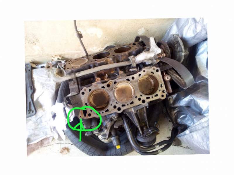

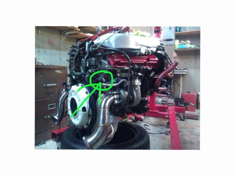

  13. Hi guys, thanks for all the comments and suggestion. Sorry if my description of the location was vague - I didn't know how to describe it! Defo not the half moon cam seal, it's defo leaking at the junction between the head and the block - seeping out where the head gasket is. So it's Almost certainly the head gasket at fault, but it's a weird failure mechanism.... I had a look at one of my spare heads and there is a large oil return gallery that runs near the "lug", so that so probably the source... What I can't fathom is why the gasket would fail there as it's low pressure - nowhere near the combustion chamber or fire rings. I tried to take a photo with my ihone but it was un- unusable. I'll try to find a relevant picture and post it for context....
  14. My engine has developed a small but steady trickle of oil from the interface between the head and block, at the lug that is at the back of the drivers side bank. It only leaks when the engine is running and takes about a minute before the oil starts to appear, and then weep down the block... I have tightened the m6 bolt than fastens the head to the block in this lug but this hasn't cured it. Has any one seen this before and is there a solution that doesn't involve pulling the head off? :( So frustrating!!
