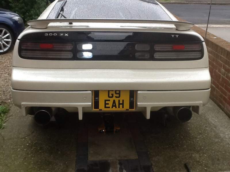

  9. Must have had a senior moment this morning! Here's my plate from three months back! Mines not offset!

  11. My plate must have shrunk in the car wash officer:whistling: Has been on for 3 months now, but MOT end of the month will stick on
