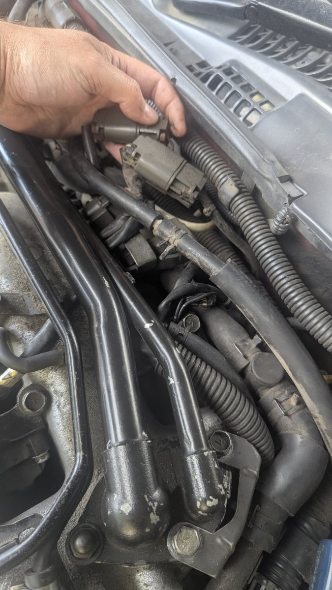

  1. Thanks @AndrewG - So would assume the knock sensor. Will look to reconnect the broken wire. Not sure if you can make out well on my picture but one wire is intact, while the one my finger is on is broken.

  3. Thanks @Stephen & @AndrewG I've just done a first pass with contact cleaner and a flat head, I regained 2 cylinders but I believe I'm still 2 down. So leathered the ptu connections with contact cleaner and will let it drip dry, then try again. Interesting note, my PTU has been relocated to be next to the air intake. Assuming to avoid head cycles.... I have also just noticed this severed connection on a connector, any idea what it's for?...image to follow.

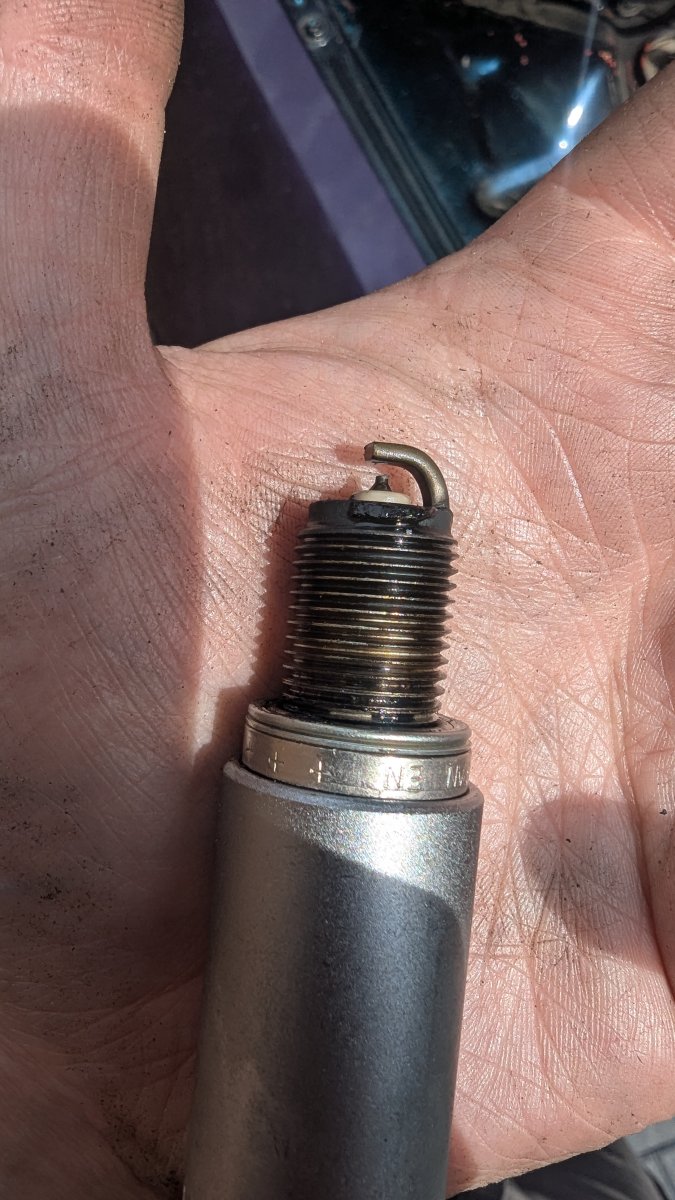

  4. Ok, got her starting and running again. Only seems to be firing on 3 cylinders now though. New spark plugs, new coil packs obviously. Anything else to consider changing?

  6. @JaiKai - I'm at the point of having all the spark plugs out now. (Had to do it around work)... So the plan is to fit the new battery now, then crank it with the coils and spark plugs out. Is that right? When should I stop cranking?
  7. Just a case of cranking the engine with the spark plugs out I believe? - I'm learning as I go, be patient 😂
