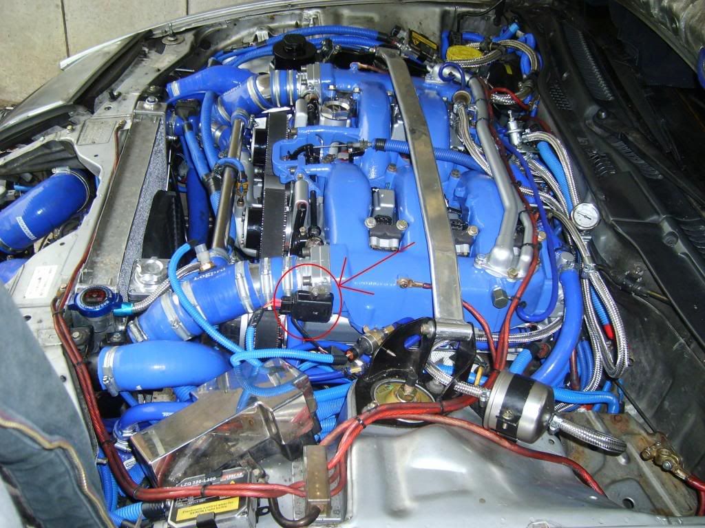

any infomation on this car
hi ive just got this car and would just like to no if anybody has seen or worked on this car and can tell me what has been done to the car in the past as i have no idea of what has been done to my car

rite it stalls after being revved like at a roundabout but im going to adjust the idle valve tomoz
it also sends plumes of black smoke after boost
and also sometimes its like a blue smoke which it oil but that was only once
ive orderd a new apexi filter as the other 1 looks really old and also some new plugs and other service stuff
i really need a new underhood wiring loom as some of the wires have cracked but id like to no what else is wrong so i can save abit on the p+p when i order the bits hope this helps but if u need any more info just ask
yea used carb cleaner this moring which seemed to make a differance at the time but after taking it for a drive just went back to normal
oh some1 said i might have a boost leak would that cause them problems ?

boost leak could be the cause of your stalling problem, are you running boost jets?
If so..
the pipe they are in may have come of which stops the actuator to one of the turbos opening at the right time. it will also cause black smoke and a farting noise when you change gear on boost.
a boost leak is more likely to be around your dump valves, probably the original ones are still there or a blanking plug has popped out
Hope this helps
the dump valves look quite new it does (fart) sometimes what are boost jets?
also if i remove the dump valves clean them up and then put them back on making sure everything is tight would that help?
boost jets are small metal restrictors which go inside the small pips to the actuator, they're a caveman method of raising the boost.
I use them :)
the pipe is located underneath the large inlet pipes to the throttle bodies (the middle two big pipes)
Have a look in the light and see if they are connected, when people install them they tend to have problems squeezing them into the pipes and just connect them back up by a cm, rather than an inch.

It would also be worth doing an ECU fault code check to see if anything has registered as faulty.This would also point to what may be causing your problems. It will only highlight electrical items that may be failing.
