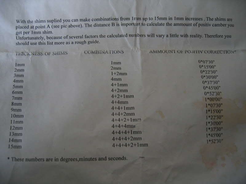

These are some guides from another shim kit , might give you a starting point when you start shimming . HTH
Only trouble with a shim kit is that it's not that adjustable. I considered it initially when looking for a good setup for mine, but personally, I'd go for the rose jointed adjustable tension rods and adjustable camber arms. Easier to tune and is a little more precise.
OH!Thanks it is a good document for me...
This is the maximun adjust that we can make in the car, buy it isn´t sufficient
