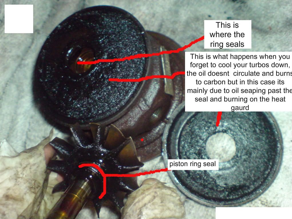

Decatting does not damage the seals in anyway, it reduces back pressure making it easier for oil to seep past the exhaust seal rings, thats if they are on their last legs. If they leak then you can put the cats back on and your back to normal.

I would do some searches about decatting old zeds.... Its generally not a good idea. Removes the back pressure which can accelerate the weakening of the turbo seals, remember engine has got to come out to replace them. Its up to you.
