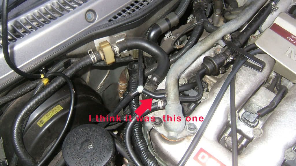

Did you ever find out why your emissions were so high?
No actually I didn't. JD suggested I 'pinch' or remove a small balance tube on the top of the engine during MOT - which I did to the bewilderment of the tester. It obviously folled the machine and passed. I shall check it out next time I'm up with JD. Don't trust anyone locally - they have no clue.

hi. could you tell me which 4mm vacuum hose you pulled off to puzzle the mot man ?
ask JD he will advise.
