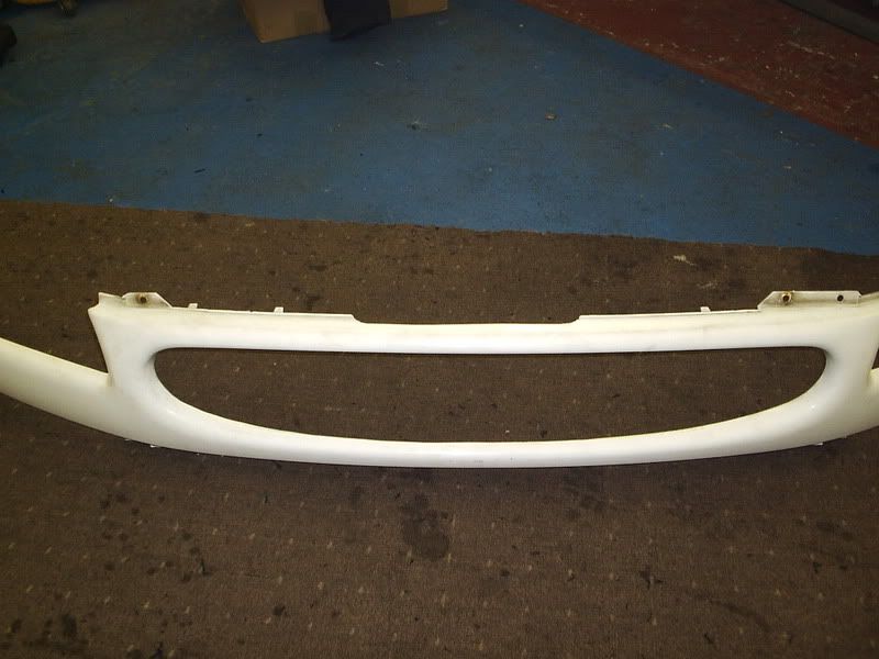

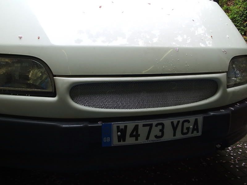

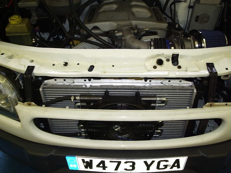

Managed to squeeze in the electric fan!-but the original grille won't fit over it so I had to make the surround 1/2 inch shallower (the white bit) and fit 'go faster' mesh!-at least it keeps the stones out...........;)
Not long now......................:dance:
Looks quite cool with the mesh anyway :D :bow:
That's gonna be feckin awesome when finished :D

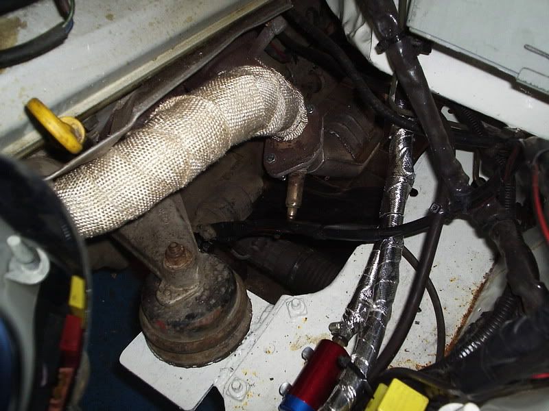

Been trying to cool things down today,got the manifold wrapped,also the fuel lines.

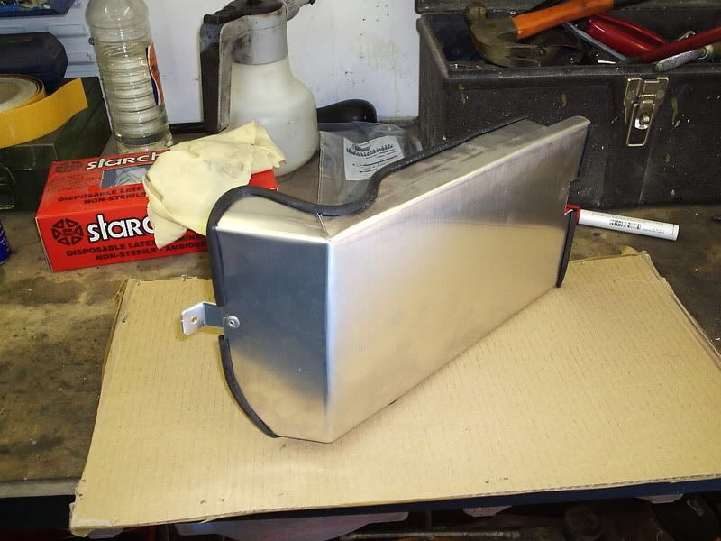

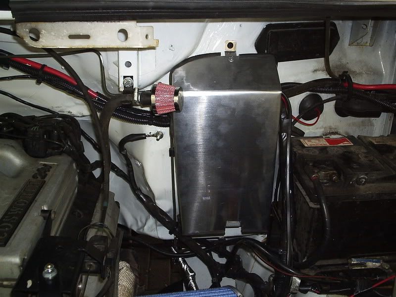

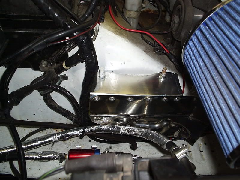

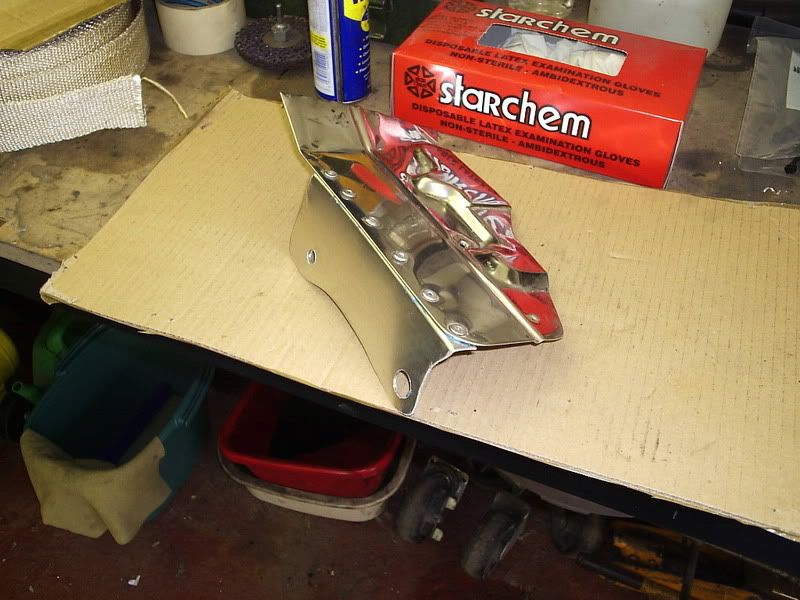

then made a cover for the ECU hopefully keep heat and water off it!
And another for the relays down on the n/s.......
And fitted....

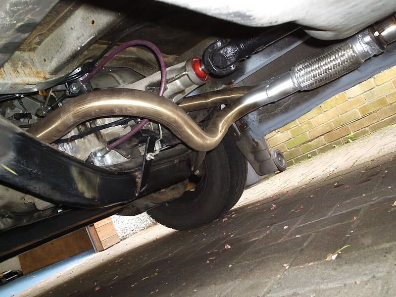

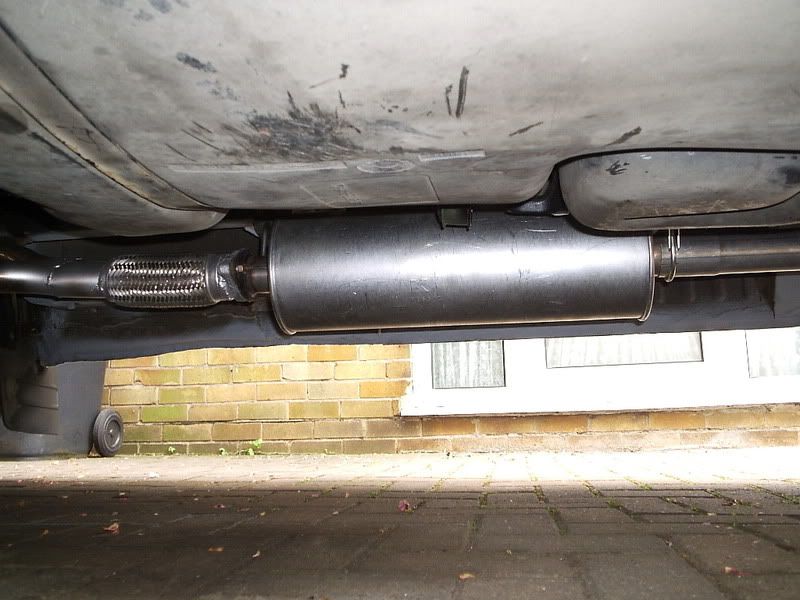

Got the van back today,with it's stainless d/pipes done!
These are coupled to oe boxes,a,to keep cost down and b,so I can relace em' when they rot!-unlikely in Spain tho'! LOL!

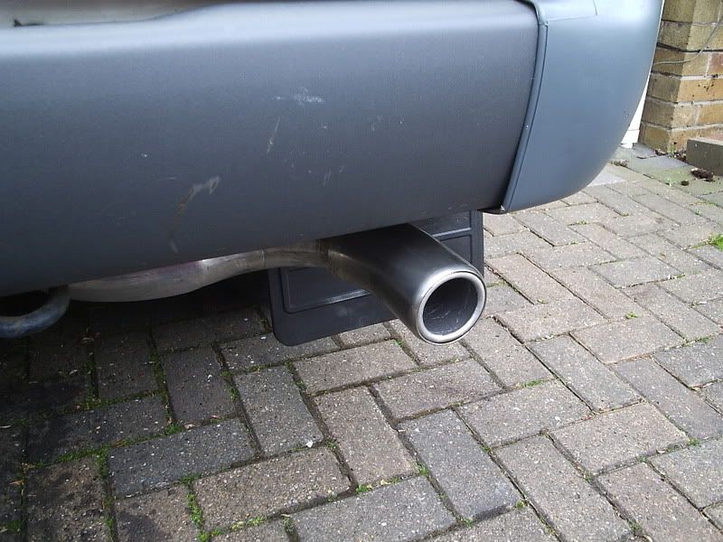

He even made a 'bling' stainless finisher for the tailpipe,nice man!:D
Oh1-and it sounds just right!:)
