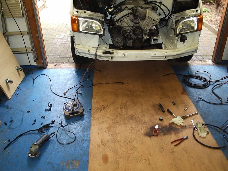

Thought I would start here as today saw the 'offical' start of the Cossy conversion!
Done today,removed prop,tank,engine and cleaned the bay up a bit for painting.
The pics!:cool:
Soon ready for a trial fit of this,all decatted an' everything!
I was hoping the Scorpio sender was going to fit my tank but no!-the sender resistance was wrong and the flange to big,so I came up with this 'hybrid'-my sender with the Scorp' pump fitted,sorted!
Watch this space.....................................(again! LOL!)

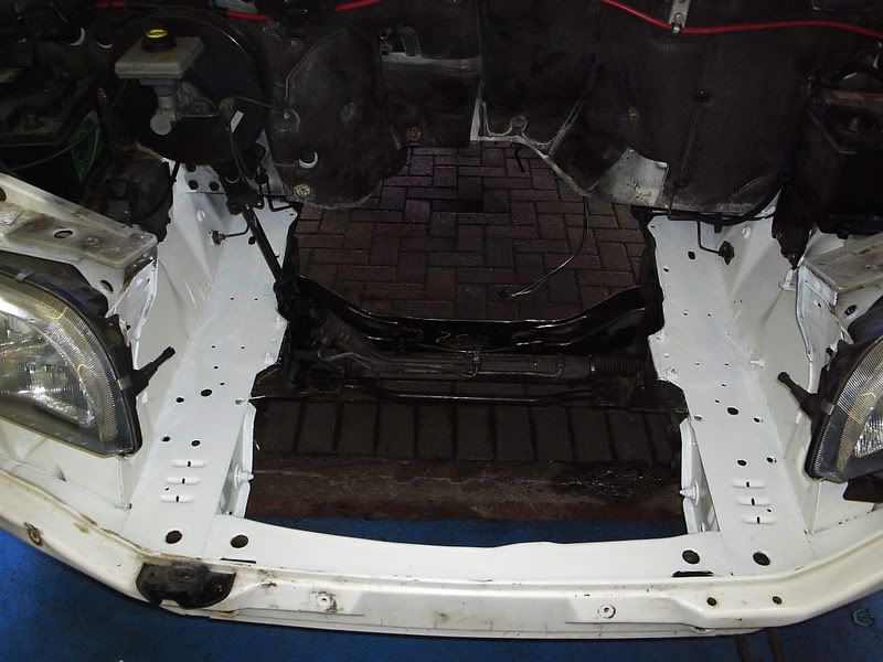

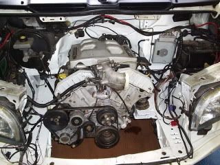

Well got the bay painted and after a lot of in and outs with the engine,she's finally in!!:hyper:
probably start the wiring tomorrow,should be fun!:wack:
Later........

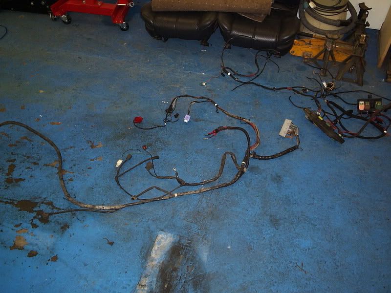

Well today I attempted the wiring!-don't look like I got much done but all day and managed to get starter,alternator,main earths etc in.
tomorrow I have just got to wire in the fuel pump relay and clip everything up,should have seen her running tomorrow but some dope forgot to order a fuel filter!:wack:
Getting there............
