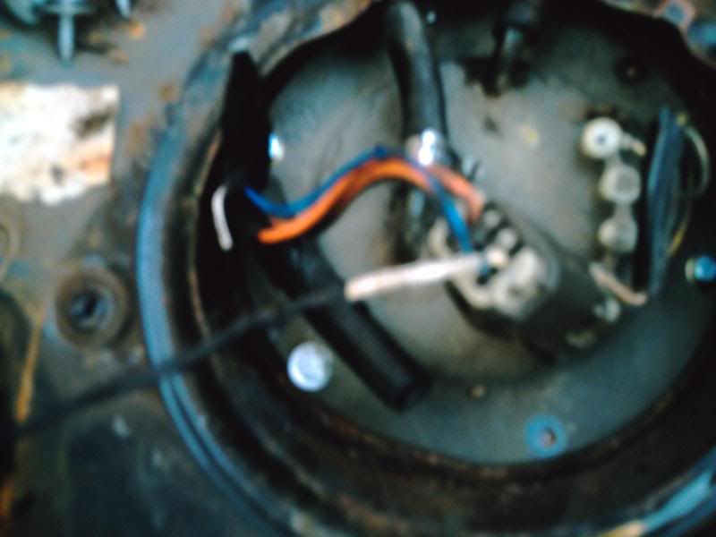

4. Check power was getting to Fuel Pump via Miltimeter (Got just under 12 amps from one terminal and about 6 from another?)
5. Removed Fuel Pump and had direct feed sent to it (It worked)
6. Changed Fuel Pump Relay (No change)
So car still not starting and no fuel being delivered.
My last stop before setting fire to it is the fuel pump ecu I did have a look at it and found the connecter to be a bit singed
Does that point to the FPU?
Thanks for that. I was about to go out and carry this out when i remembered there was a earth wire from the fuel pump in the rear of my car connected by somebody to the body of the car. After reading the bottom of the article it seems my FPU has been bypassed via this method. So as its probally been that way for some time I guess the FPU needs replacing?
