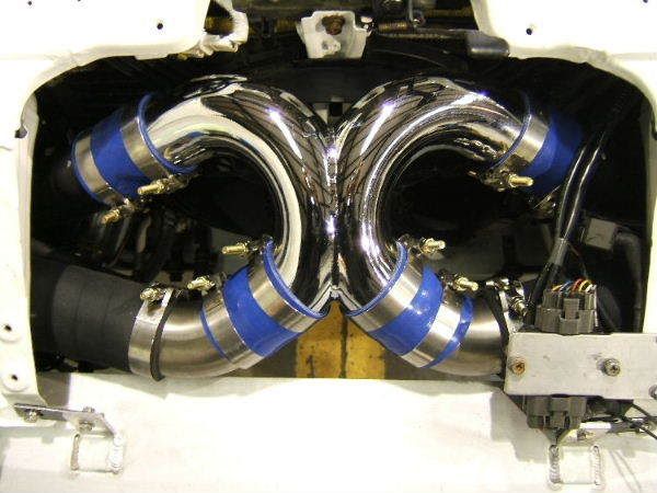

Here's what a doolz looks like and gives 2 independent air feeds. 1 per throttle body. You then stick a dual cone filter on each bank.
