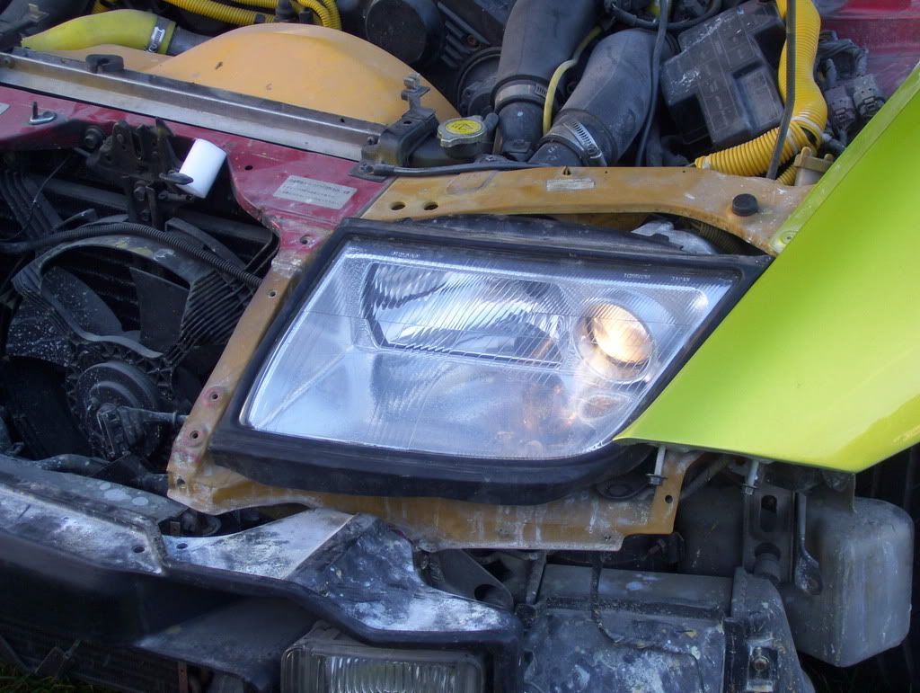

Light with normal bulb... notice the yellowish tinge...

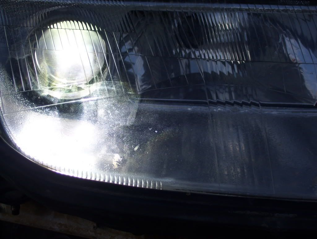

Now a HID bulb...mmmm nice and white...

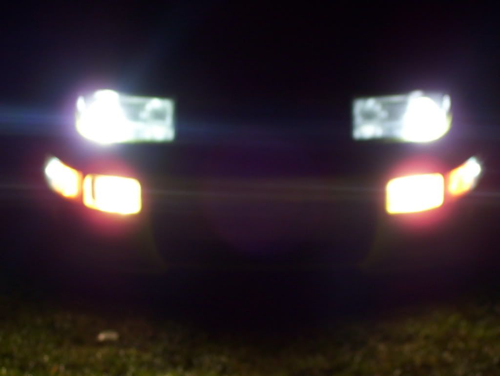

At night with HID's on and the LED side light bukbs that Danny supplies...

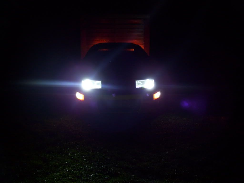

Another one but with the Fog lights as well..... light are bright than the fogs now!!!
