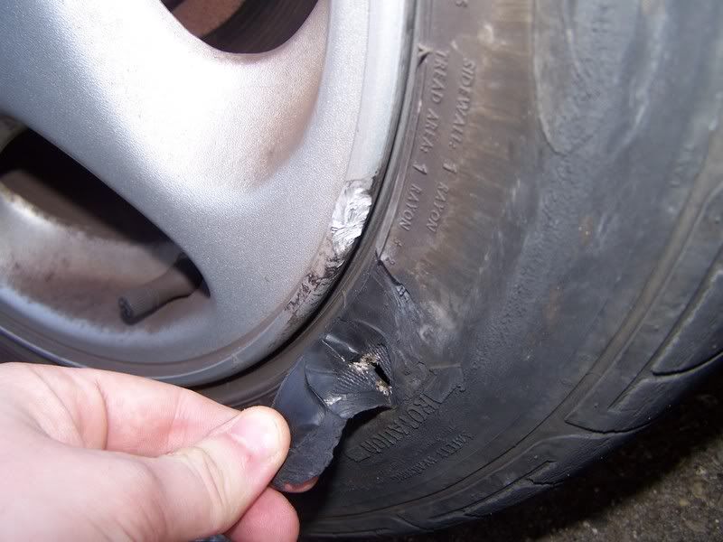

yeah. got a picture which i will show later. tyre has a nasty tear. wished i had a manual when it happened as i would of shoved clutch in. unfortunately i auto so engine was still winding down after taking foot off. wish i had enough time to shove in neutral.

hmmmmmm thinking something has caught my tyre causing blowout. look at chip in alloy. really wierd as was drving sensibly. need to check road me thinks
You have some serious friction wear on the tyre wall...
You sure you hav'nt clipped a kerb or something? Or was that caused in the accident?

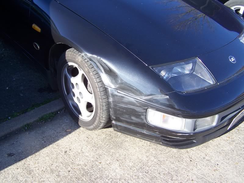

im afriad i don't know. i felt and heard something but i dont know what. all i know is the cars back end went crazy. got spare tyre and getting a new one for the dead one but i don't know what to do about bumper and fender! reckon i can get someone to beat out the bit behind fender/bumber? i worry that buying one of each wont just do the job. surely a new bumper and fender won't fit onto the bits bent in? annoying thing is it went in for a oil change and brake pad change and was told tyre has loads of life left. guess i shouldnt of took their word for it

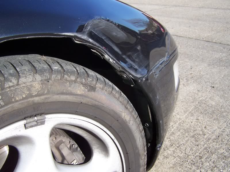

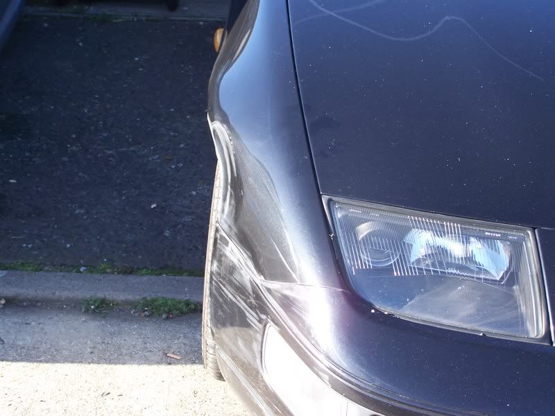

A good body shop will pull that dint out and the bumper is poly propelene and will pop back into shap with alittle heat from a heat gun.
Then its jst a a blow over the wing and bumper. would have thought £300 ish. not worth claiming for it or you'll pay more in increased premium next year than the cost of the repair.

Yep easy repair.Tho you have creased the line,personally would replace wing but i`m fussy,bumper shouldn`t be a prob and it`s the washer bottle,empty space and a bracket behind the damaged area so not too bad.Wed would be best for me to have a closer look if you still want me too.Will resend mail so you can contact me if needed.

Any respectable body shop will fix this for you...
Have a drive around and get some quotes.
Marks right should be no more than 300 quid to fix up.
