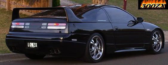

the rear bar can be sanded back by hand,be careful using power tools or the heat build up will make it a sticky mess
Yes, because I did part of the rear bumper.
The bumpers are actually a finish that's moulded into the plastic itself. It's only a few hundred microns thick, so smoothing the plastic off there won't really effect structural integrity. You have to be very careful though as you can sand down low spots and make it loose it's continuity. Luckily, the body shop knew what they were doing and did a good job. Front bumper takes some time on the TT models.
Sides are different. The sides have a bitumen stone guard on them which sands back very easily. Don't sand it off completely, just smooth it off so the finish is even. You still need some protection there.
Makes a nice clean subtle difference. The stone guard is about the only standard feature of the car that I really dislike. Especially noticable on dark coloured cars. Well worth doing.
