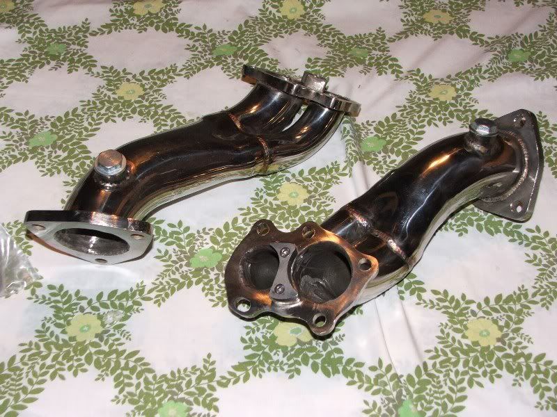

you'll have to think about 5 bolt downpipes as well. Mike Smith are the best option for both these tubs at the moment.
yup that's the ones.
I would have got those myself but they were not avilable when I bought my Greg Dupree manifolds and downpipes.
