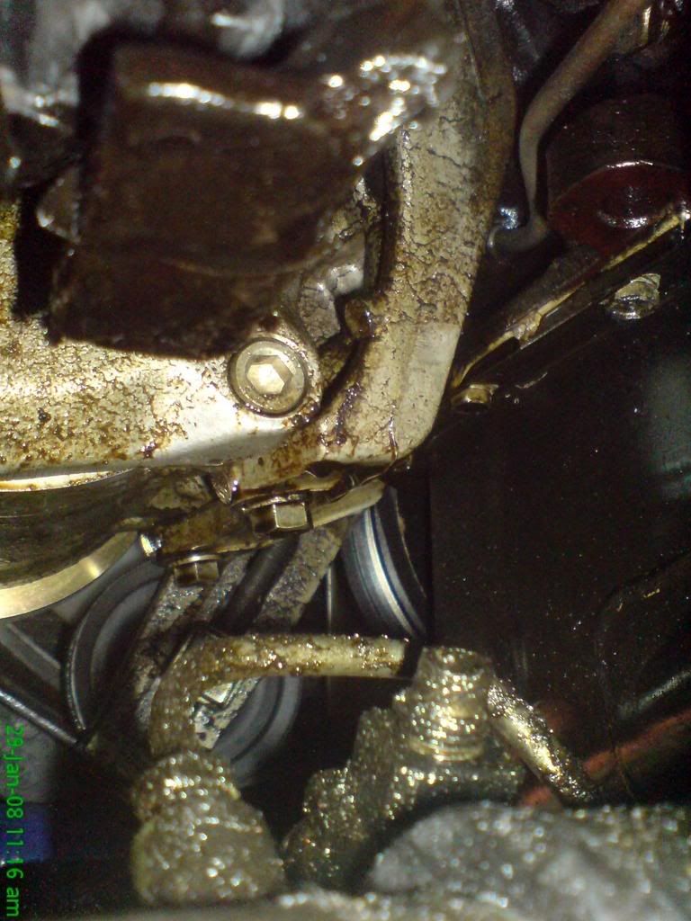

I took off my battery today and had a look behind the engine, this is what i saw.
note the red circle is an oil trail
Then i saw this.
Pipe is split so i changed it with a fresh one and inserted the spacer from the old. This is where it came from.
I thought i got lucky and maybe this was where the smoke was coming from but sure enough i went for a test drive and its still smoking around that area.
The rocker cover gasket doesnt seem too oily but then again i cannot really get a good look at the other side of the cover.
any ideas people?
as i want to book it in to have the oil leak fixed but i want to be sure where its coming from first....

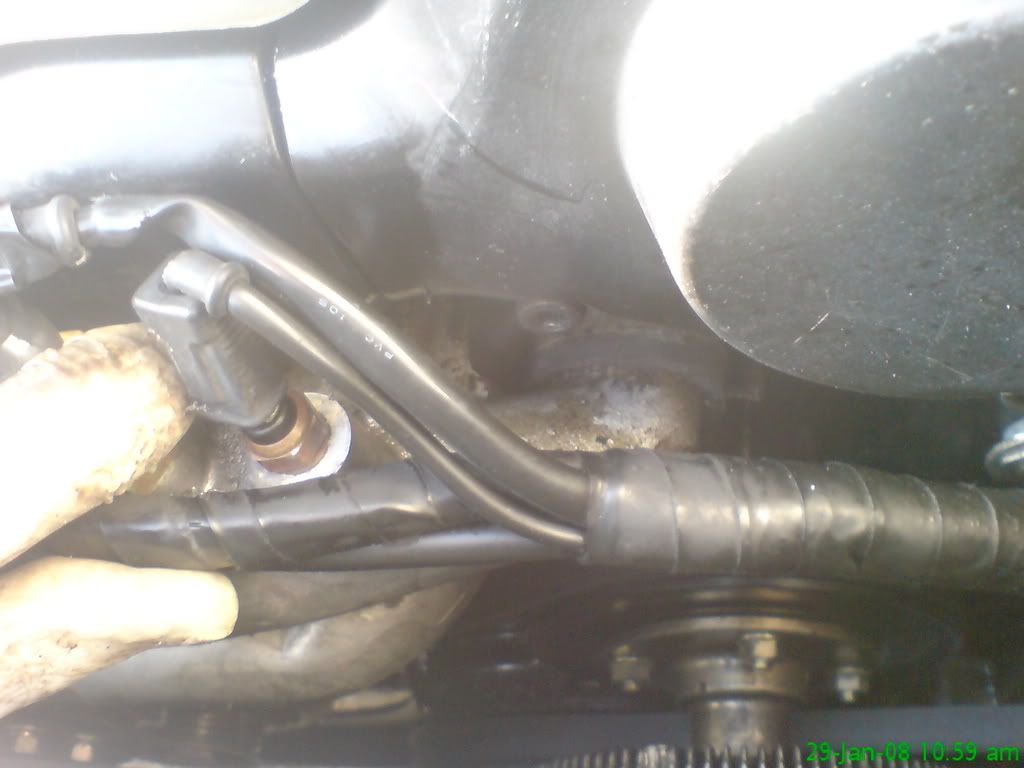

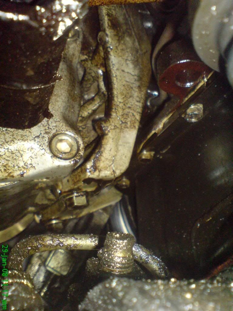

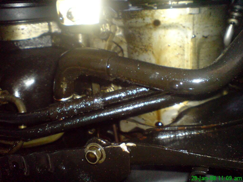

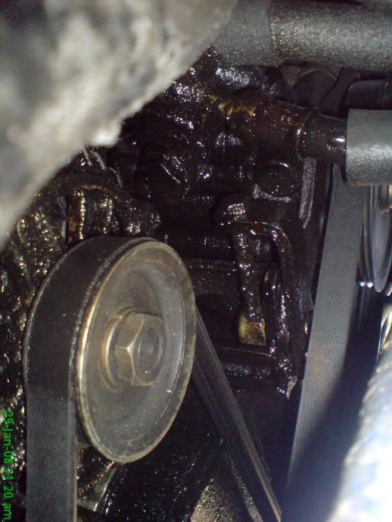

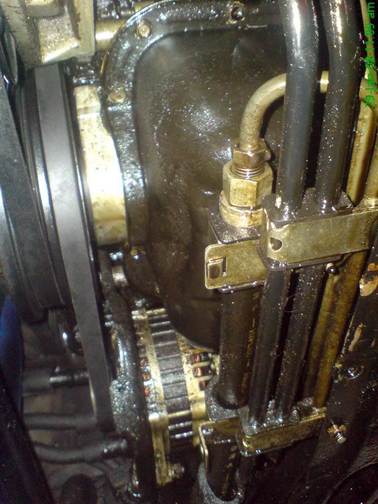

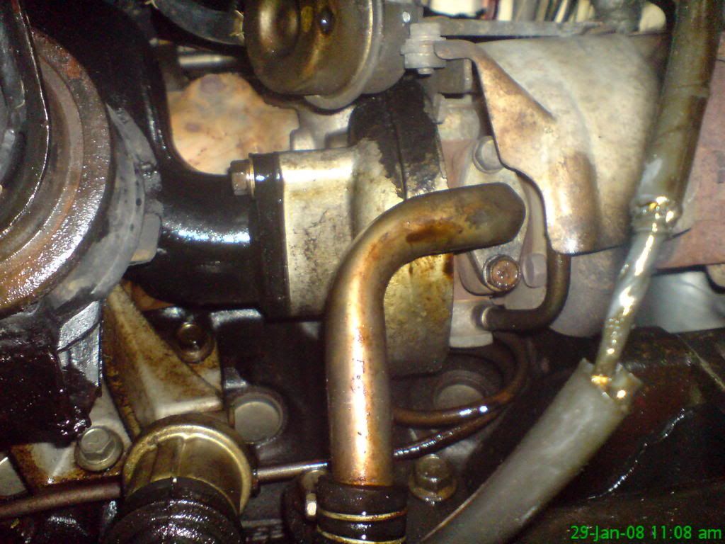

Ok had a good look under the car today and took lots of pictures.
most of it is coming from the front if not all of it. i dont have time to buy that aero spray but i think il do that 2mow. then i can have a better look at the source.
its on the aircon compressor/the altenator/
it has travelled along the bottom of the gearbox onto the gearbox mount and on the exhausts about halfway.
i also noticed a bolt missing from the gearbox where it joins the engine so i put one in.
i also tightend most of the pipes.
I noticed the bottom rad pipe was not tight and leaking water so i tightened that also.
Well at least its not going to rust under there ;)
here are the pics. enjoy..
i cant see the pics at work but if its comin from the front it could be the front crankshaft oil seal, but like i say i cant see the pics, i'm just talkin s**t now :slap: :xxx: :smash: i'll have a look when i get home.
Jeez, that's bad. You'll need to get a lot of that cleaned off before you can work out where it's coming from. I suppose the good news is that it'll be a big leak, so it shouldn't be too difficult to find.
It only leaks when its driven.
and a bit on idle.
i had the car running while i was underneath and i couldnt see the source.

Crankshaft seal isn't too bad - basically at this point I'd start pulling the timing belt covers, belt, sprockets and back plate off and start trying to figure out where it's pi**ing out from.
My top suspects based on that oil-massacre:
1) Crankshaft seal
2) Camshaft seals
3) Cam sprockets
If you can't find the leak on the front of the block (i.e. cam or crank seals) then I'd be tempted to put the belt etc back on and run it with no covers - if you spray a neat line of oil on the underside of the bonnet, it's likely the intake sprocket (where it mates to the camshaft seal) or the end plate that houses the VVT mechanism.
But seriously.. get that fixed - it must be costing you a fortune in oil!
Whats strange is i changed the oil last month and driven a good 1000 miles and only needed to top up oil twice, looks worse than what it is i think.
I think best bet is to take it to a good z garage and let them change the timing belt alone with all the seals????
if it still leaks after that then il hang myself.
a good zed place should be able to tell you where its leakin from

On the very 1st pic, Is that red and silver pipe/harness/whatever a std part??? :confused:
Was there when i bought it, nothing is seeping from that... why you ask?
clean all the oil with a solvent type spray and get it dry then cover the area in talc powder,yea the stuff your bird puts down her knickers to smell nice then get the car up on jacks or ramps and run the motor,light a ciggy and just wait and watch the talc go oily where it leaks
Because there is one on john300zx pic, and i have one on mine. I thought some little jap had bodged it befor it came over :D

Mine wasnt as bad as yours but I still had a mess on the driveway. It looks like a front end strip down. The only way to prob tell is try and clean it as best u can then watch from underneath and see where it comes from. One small point on one of your pictures the oil looks red which would indicate possible a power steering oil leak or maybee its just the light on the oil, but maybee another vaenue to look at.
