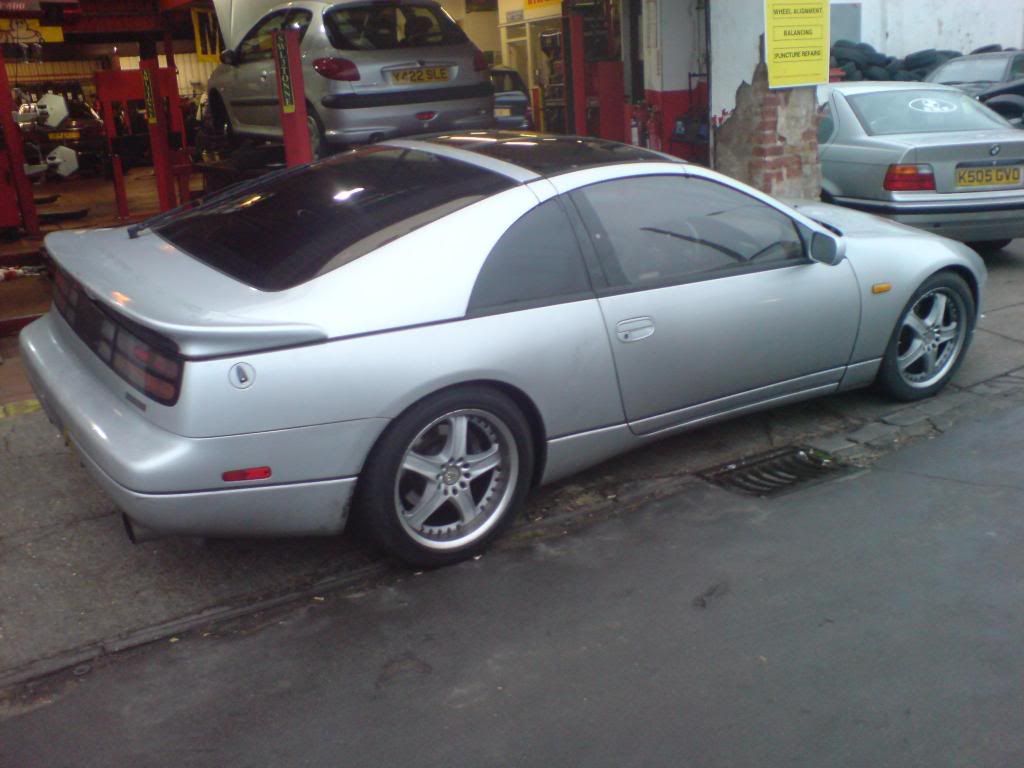

Oil leak/smoke from under bonnet
The previous owner said that he had the cam belt changed and all the seal etc etc. so why would there still be an oil leak from the front pulleys?
I dont want to have a mechanic take everything apart just to find that its not the problem, then have to pay more to find the leak?
whats the cause of oil leaking here as ive just spent hours reading up on previous threads with the same problem.
im also getting oil leaking onto the nearside turbo causing it to smoke a little under the bonnet??? could the leak from the cam travel this far as the oil could splatter off the fan belts etc?
