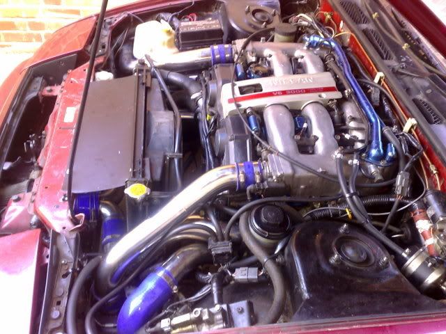

Take a huge amount of weight off a 300 and run it at 1bar :D , yup it goes rather quickly, I used two r32 intercoolers from 2.5 skyline, tubs are kinda on there last legs now.

Thanks, there are plenty of not so good looking pictures during the middle of the swap where I was nearly ready to torch it

Funnily enough it sounds like a zed with a single exit exhaust lol, I have a pipe that goes into the center of the back box and effectively cuts out the main rear box and gives it a bit of a growl, a video is in order though and long over due, Its going back into the garage soon to be pulled apart again I have a few more things to do to it and as it now thinks its a zed the engine has to come out to change a fuse, I have more room at the top of the engine than the zed does but thats it, every where else is a lot tighter.
Oh yea handles fine, I kept the engine as far back as I could.
Thats bloody impressive looking work fry1. Its tight enough in a Zed, can't imagine what it must be like in an s13 to work on. You must like torturing yourself?! What made you choose a vg30dett over an RB or something a little easier to workon?
Dont take this the wrong way but dead Z's are cheap and 400hp is easily obtained, every one and their aunt has done rb conversions to death, I couldn't afford a 2jz or ls1 and the thing that really got me thinking were the American conversions which all said you couldn't do it and keep both the turbo's in the standard location, you can ! you just have to move everything else :D
There is a thread running on nico where some one has said they can do it and are going to make a kit but its been an ingoing sage for over a year and no kit, they are making custom front sub frame and sat the engine alot further forward, I had a budget of very little and had to pretty much bend chop and alter what I had, I do have a very good friend who likes the electrical side of things so getting it up and running luckily wasn't a problem.
