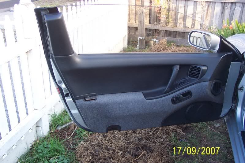

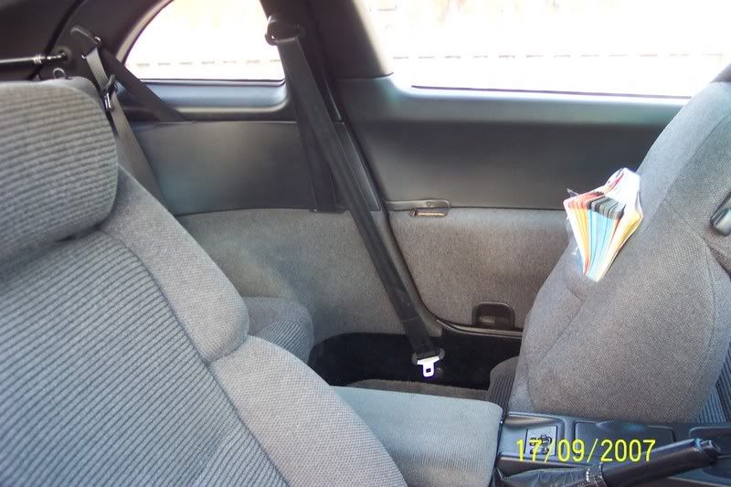

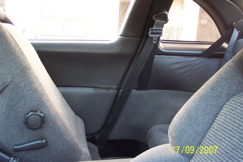

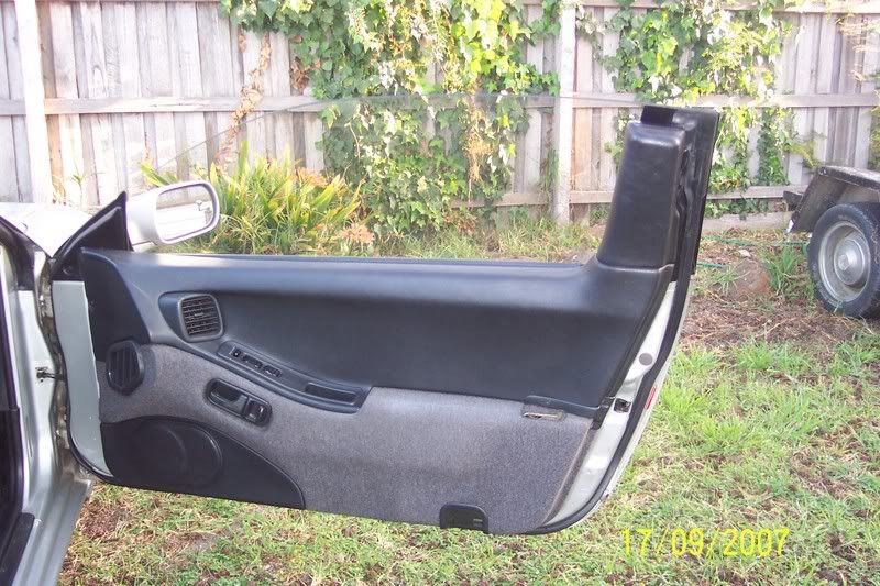

Transfered my seat belts on the doors to my B Pillars to continue my 2000spec conversion project. I had this done by a compliancer so i know it was done right as these parts are part of the safety system so i didnt want to take any risks doing it myself.
Basically the comliancer welded a nut onto the back of a steel plate which he then pot riveted to the inside of the chassis wall at the holes for the seat belt mounts. I acquired a set of B Pillar Seat belts from a wrecked ausSpec zed which fitted prefectly. Im very happy with the result and the belts feel alot tighter then my previous door mounted belts did.
Anyways here are some pix
