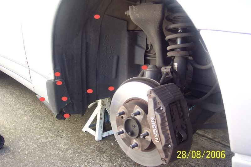

Step 2 : Passnage Side Fender Lining Removal
- I decided to take the passenger side AIV off first as this side is the easiest to remove duie to not as many obstructions in the way of the AIV airbox. Here you can see the Fender lining which covers 3/4s of the fender well for the wheel. Dotted in red are the plastic fasteners and screws which need to be removed inorder to get the lining off the car. The are 5 plastic fasters and 9 Phillips head screws in total. If you have stock mud flaps these need to be removed as well. When the lining is removed you can see the AIVs bolted to the chassis.
http://i90.photobucket.com/albums/k276/DJ_Party_Favor/RHWheelOffREDDots.jpg
NOTES: To removed the plastic Fasteners push the middle part of the fastener inwards.

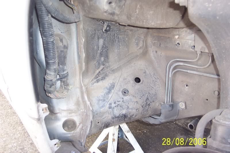

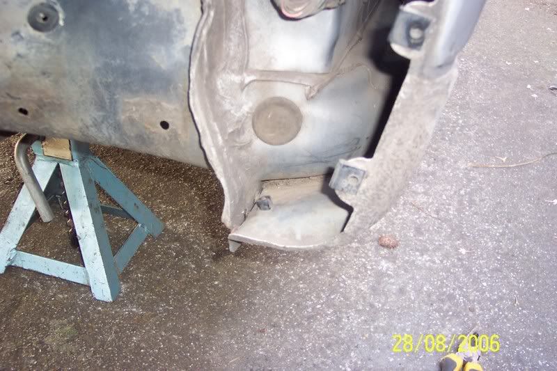

- Once the AIV has been removed its a good idea to clean any dirt build up in that area. I used a brush and vacumm cleaner to get as much as dirt out as i could. The this is what everything will look like from now on.
http://i90.photobucket.com/albums/k276/DJ_Party_Favor/DirtSpotOnFender.jpg
http://i90.photobucket.com/albums/k276/DJ_Party_Favor/RHSideChassisWithoutAIV.jpg
http://i90.photobucket.com/albums/k276/DJ_Party_Favor/RHSideFenderWithoutAirbox.jpg

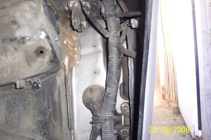

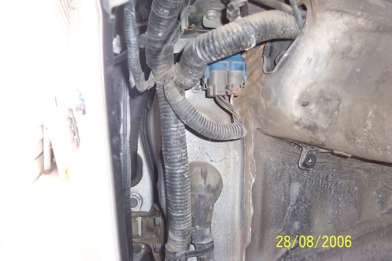

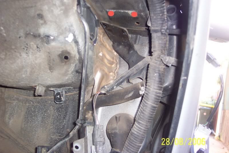

- The Drivers Side Airbox bracket has the starter relay bracket connected to it like the indicator connector bracket was. Once the 2 10mm bolts are removed replace the starter relay bracket back in its original spot. Again removing the airbox is difficult with alot more wirting looms to worry about this time, but take your time and you should be able to wiggle the box out eventually. Then remove the lower rubber tubing that connectors to the exhaust metal pipes.
- Again clean the fender with a brush and the units are now gone from the car.
http://i90.photobucket.com/albums/k276/DJ_Party_Favor/LHSideChassisWithoutAIV.jpg

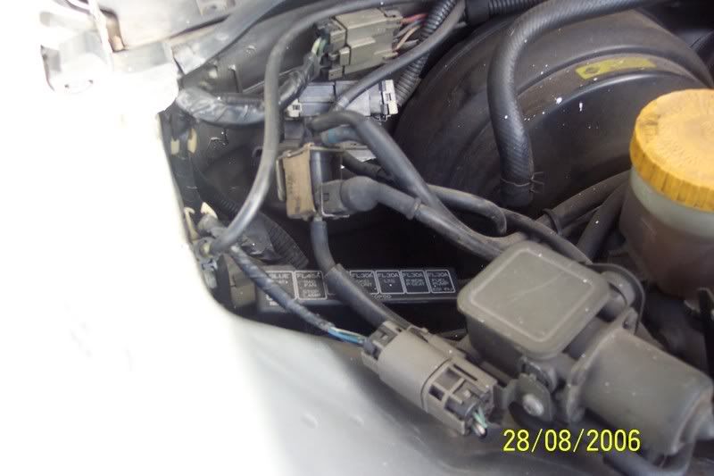

Step 6: Removing AIV Solenoid
- The AIV solenoid is located on the Drivers side of the car inside the engine bay. There is a black bracket that holds the solenoid to the car, remove the 2 10mm bolts from the bracket and then u must remove another 10mm bolt at the back of the solenoid to remove it from the bracket. Once the solenoid is removed place bracket back in its original spot.
Step 7: What To Do with the rubber Hoses
-The Hoses for the AIVs are connected to a T pipe, so can be removed from either the AIVs(which i did) or the AIV Solenoid and then pulled out through the wiring looms connectors its connected to along the firewall. The top hose on the solenoid connects to the Balance tube and the bottom hose to the ERG Solenoid. For me im going to cut the original hosing and then ziptie the hose back on its self to create a seal over the metal connections for the balance tube and ERG pipe.
As for the connector on the front of the Solenoid, u need to push the metal U wire out to disconnect the connector. As this wire connects to the wiring loom which is covered by plastic tubing and tape i left it in the engine bay but moved it to this position using one of the extra clips from the AIV system.

To block the balance tube and EGR, i was told to use a vaccum cap which i found at a local hardware store. They fitted the connectors perfectly
And here is the new look for engine bay in the area where the solenoid was. So much more room now
