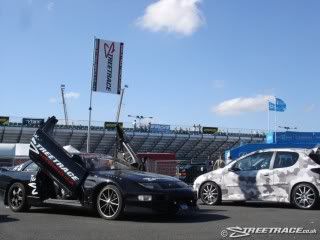

Here is the last picture i took of it at santapod before it decided to take an early retirment!!
Sharky. I saw your motor at Santa pod, infact I took some photo's of it,love the doors. Should be a cool runner once you have sorted the motor. Good luck
