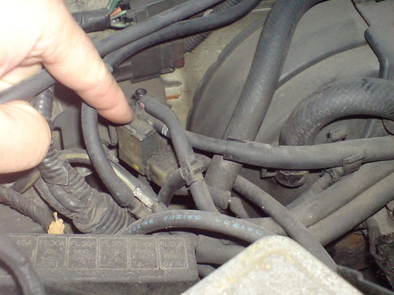

E.G.R valve pic (pics now attached), but not egr

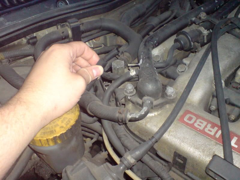

anyone got one, i removed a pipe from the plenum balance bar and it made my car run better, idle was great, and the car ran brilliantly with no hesitation at alcould i run car with this dissconected (if it is what i think it is)
when i removed the pipe the car ran great, it didnt try and stall when i pulled away, the tick over was spot on
can i drive the car without the pipe attached, till i get the prob sorted
This might not be much help but on my 90 NA that pipe operated the gurgling AIVs under the wheel arches. I removed them and blocked-off the pipe. Pipe blocked or unblocked it made no difference to the engine performance.
Therefore if unblocking yours means the car runs better, it could mean that another source of air into the balance bar is blocked causing the trouble - and the pipe you have removed is not the faulty item, nor the cure...

Taking that pipe off is a quick fix to get the emissions down at the mot station, maybe car is overfuelling? sorry I'm a bit crap lol

its the stock feed for the boost gauge
boost gauge has never worked, always just sat in the middle, car did run better
also when pipe attached, if i rev it and let the revs drop (in nuetral) the engine would nearly stall, but not with the pipe dissconected
it could be a blocked or sticking air bypass valve,at the back of plenum by the batt, with you taking off the pipe its let air bleed into plenum to correct a/f ratio for a correct idle

Does the car run just as well if you plug up the removed pipe?
never tried it bud, will have a go tomorrow
deffo sounding like something is blocked

its behind here allan
do you mean air idle valve, it has the yellow connector and a grey one on it, im getting a buzzing noise (sounds like a quiet fuel pump noise) from that area
your balance bar will probably be clogged up take it off not a big job and give it a good internal clean you will be able to get a cleaning fluid that you can spray or pour through it and you will find that is the most probable cause
the AAC valve at the back of the plenum on pass side can also stick i had this prob and cleaned balance bar then took the AAC valve off and cleaned that to never had any bother since.

The AAC valve in old money is the choke. If it's stuck, it's like driving with the choke fully out - so yes, you'll get poor running and very poor fuel economy (not a word commonly used on this forum).
Take it off, squirt with WD40, rattle it about to make sure it's loose (insides) and put it back on...
