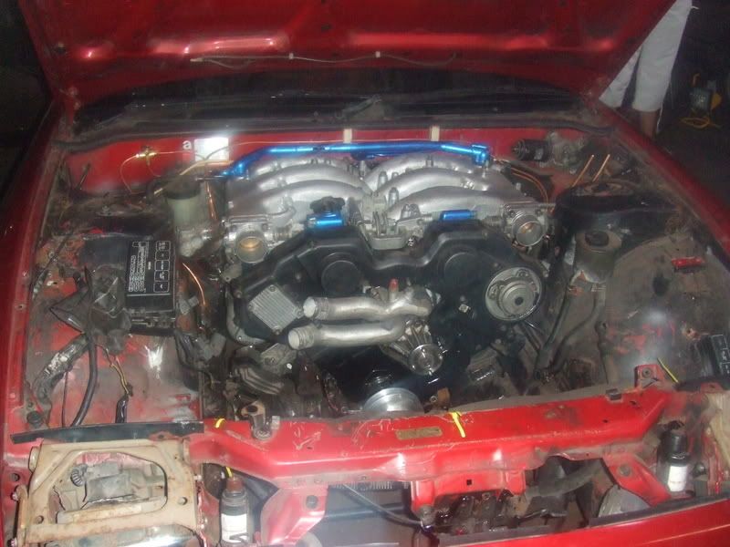

Right i see where the confusion is, its not the twin filters thats the problem but the space and the running of the pipes, it would be much better for me to have separate intakes for each side of the plenum, no y piece just separate intakes one of which would have the afm on it, if that makes it clearer

here's a pic of the little engine hiding in the bay of my 200
