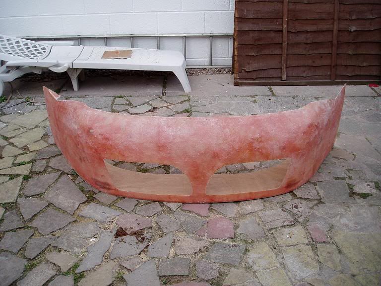

it turned into a sunbed?
o yes i see the finished project in the back ground :rofl:
A work in progress I think, although quite how much is being done at the moment is anyones idea!
Why don't you ask him directly? ;)
Still going ahead just been a bit snowed under with engine-work/music/life stuff recently. The bodyshop my car was at decided to not continue the work on my custom wide-arches which left me right in it so my priority also switched to finishing those off first (they're about 3/4's done). But back to the bumper: the photo above shows the first mould taken from the plug. I subsequently took another mould from that and the next job is to attach all the fixtures, tidy up the front air dam and cut holes for the fog lights, then after a sh1t load of smoothing it's ready for the final master mould to be taken (already got a company lined up to do that as it's not something I want to chance myself!).

In a word, yes. After he lost his main painter and other bodywork guy he became swamped with insurance work. My car kept being pushed to the back of the queue (understandably) but the result being it hadn't been touched in about 6 months. And with the engine work coming on apace it was turning into a poor situation all round. So I've got it back, I'm finishing the arches myself, then taking them to a pro for the final Grade A finish, then off to a fibreglass company to have masters made. I'll then be selling the kit which will consist of not only the four arches but, if everything comes together, possibly also a complete replacement rear bumper, front bumper, front splitter and rear diffuser (although the arches are designed in such a way that they can be used with any front or rear bumper with minimal work)
