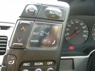

The Climate control unit i was talking about is this one
It doesnt have awp readings and the writing on the module is slightly different to the electric modules from the 89 model i have
This was taken from a 95 jap-spec
Thats the series 2 onwards climate control. It changed in late 1992
