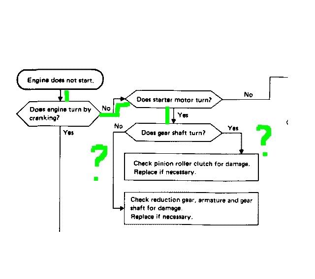

I found this on the service manual. But dont know what is means from there on.
that flowchart is for function checking the actual starter motor assembly. you would have to remove it to do those checks, but if you engine is turning its likely not that.
