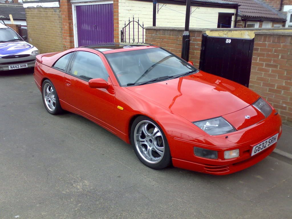

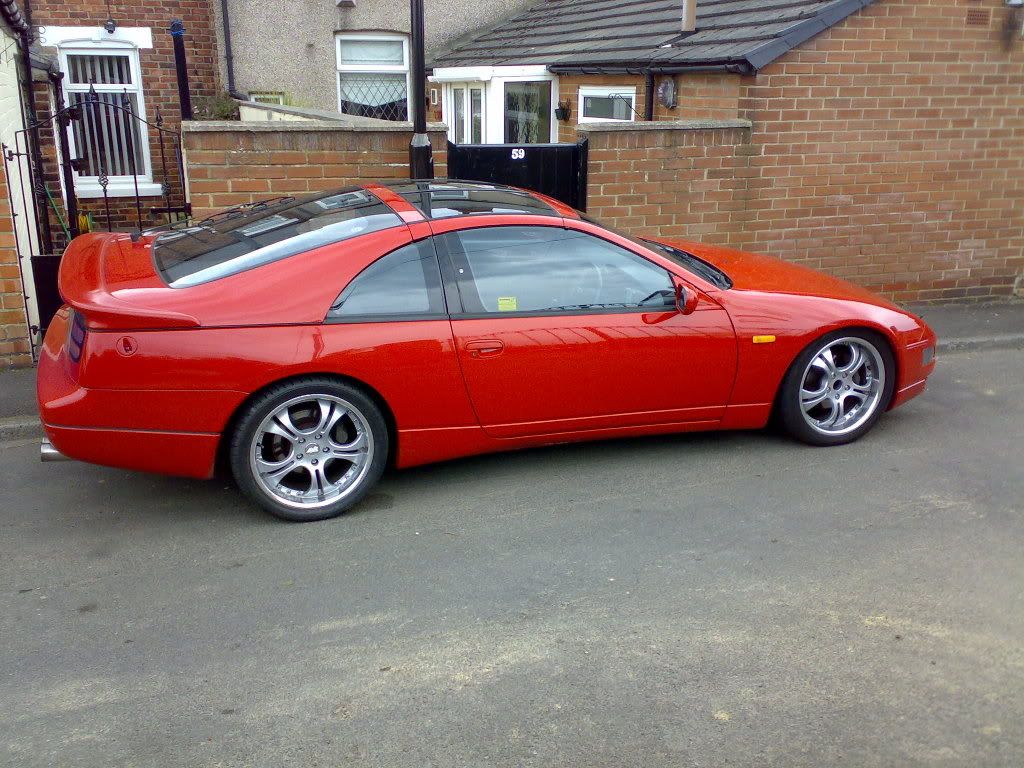

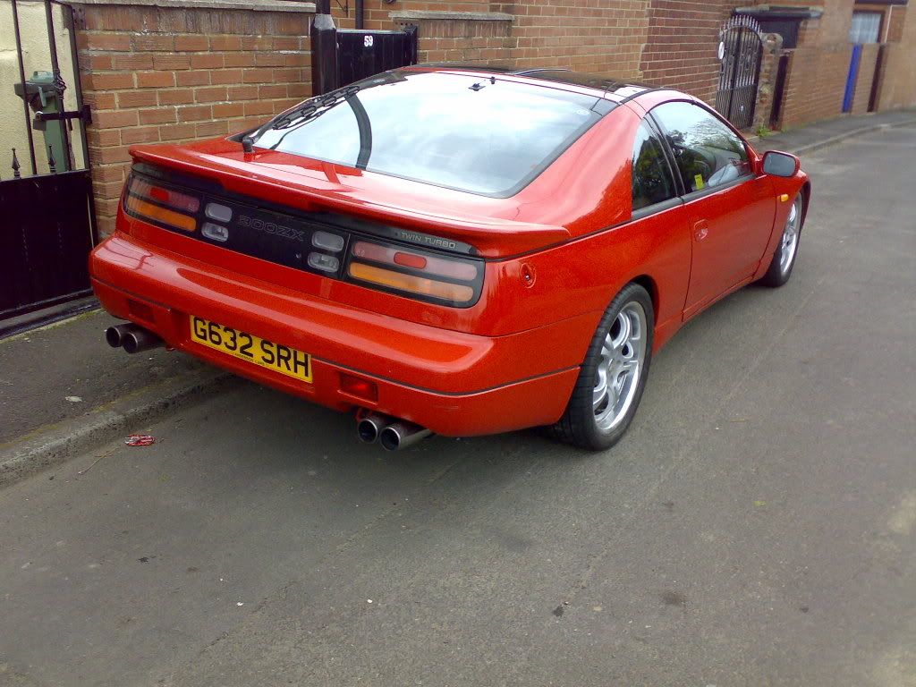

sounds like it should mate, proper nice. runs well too
that looks like a niec very clean example bud, and the exhaust sets it of nicely without being over the top
