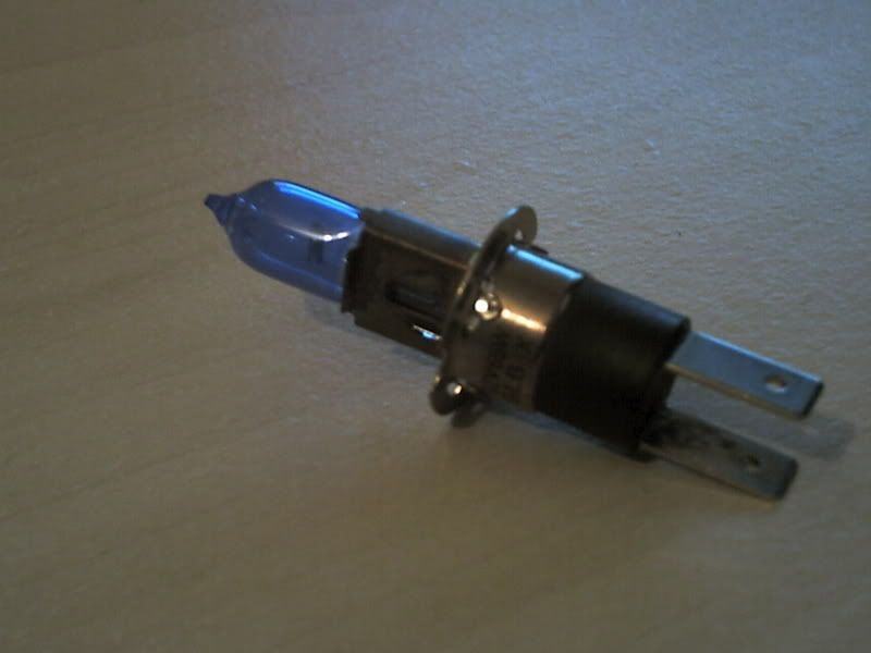

Right, I've got a headlight bulb out, so I removed it and took it to halfords to get a new set, the guy in the shop raised his eyebrows and said he's never seen anything like it.
So having tried a few more autoshops etc, same story.
Heres a picture of one, anyone know where to get a new set from, or do I need to order a set from nissan?
:confused:
They are H3C bulbs. Look in our traders section - Danny at DTA sells uprated ones or Luke at the Z Centre sells the OEM ones.
Alternatively you can do the wire conversion to UK spec bulbs (do a search here) then you can use regular H3 bulbs from Halfords.
Richard :smw:
Do a search on here it's been discussed a million times LOL
You either need H3C bulbs or the easily available H3 and solder an earth wire onto it (or earth the inside of the headlight)
Right after doing a search and finding a 'how to' about converting normal h3 bulbs, I'm now going to do that, off to halfrauds again then.
Thanks again.
