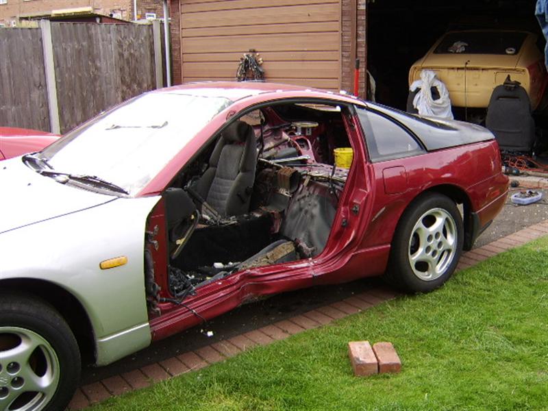

as you may remember Paul, it looked something like this when you came. :shock:
I had to wait a long time to get a space on my mates jig to straighten it and I ended up needing to buy a whole extra car just to get that sill/floor section which neded replacing.
At the time quite a few keyboard experts said what an easy repair. Well it wasnt I can tell you. The entire shell was "bananed". My jig man Mick is however a master craftsman in his trade and all is now "strait n true". It took me nearly a day just removing that silver shell cut and preparing it to weld in. Similarly ALL the sound insulation in the corresponding car floor had to be cleaned back to bare metal before Mick could start to pull it on the jig.
