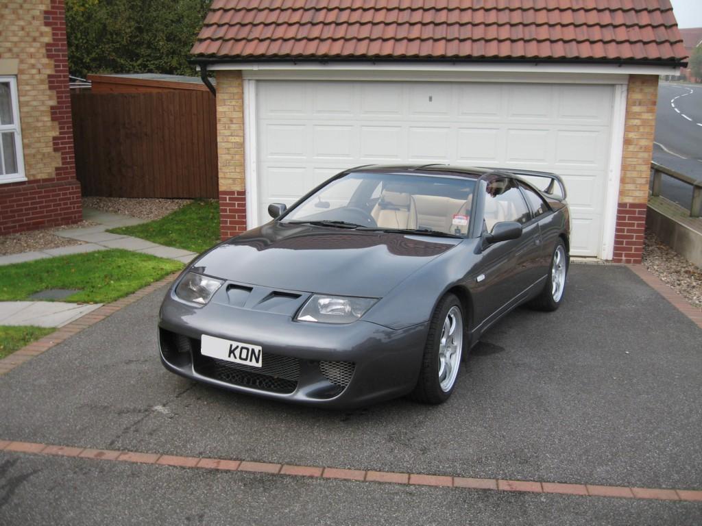

Anyone know the offset of Factory 18" 350z wheels and the 18" Rays wheels.
and will they fit a 300z with no mods? I know the offset for a 300z is +35.
Yes, they do fit, dunno the offsets offhand though.
Ok thanks! would i need any spacers front or rear? as they are 8j for the standard 18" wheels not split size's like the UK 300z :cool:
Nope, bolt straight on, look quite good too. And then you could fit some pukka brakes too !
Ok Thanks for your help :D
30 offset for 18" oe rims front and rear.....8jj
30 offset for 18" rays front......8jj
33 offset for 18" rays rear.....8.5jj
Cheers :)
look at my thread in the pics section, they just bolted on they are 350z 18" rays.
