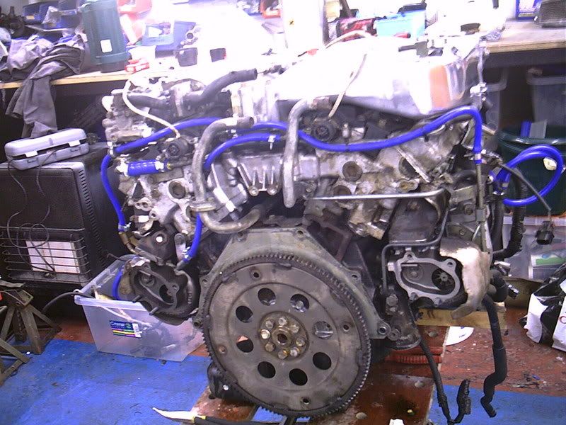

any1 know where to get the complete silicone hose kit for all cooling pipes. ??????? :rolleyes: :rolleyes:
Smithy can supply any silicone hose you will need. Check the traders section, Smithy's place...
These are the new turbo water feeds for a plenum bypass , all come off the water pipes at the rear of the engine that feed the matrix .
These are the feeds that normally go under the plenum through the throttle bodies and snake their way down to the tubs :nono:
The metal pipe on the right side above the turbo is the only original pipe you leave on but this has a small section of rubber tubing connecting it to the turbo , this will need replacing just to be on the safe side .
It all can be done with the engine in place , on the N/S you,ll have to take the battery out and remove the hard pipe coming off the turbo to gain access.
On the O/S just need to remove the hard pipe off the turbo and be prepared to cut your hands :smash:
It,s done with 6mm silicon pipe from Smithy,s HTH

did you bother removing the metal pipes from the throttle bodies like it says to do on tt.net?
I have rodder's engine and it looks like he has done the same bypass as pictured above but when Pete and me removed the plenium the metal pipework was still attached to the bottom of it?

bump, has anyone bothered removing the metal water pipes from the throttle bodies by drilling them out as it says on tt.net?
