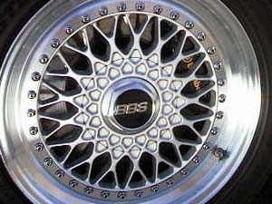

I have a set of these alloys :
http://www.ne.jp/asahi/z32/na/images2/foot.jpg
and would like to have them refurbed. In order to do this I will need to remove the 40ish lugs around the inside lip. Unfortunately they dont seem to accept an allen key, torx driver (inside the lug) or socket (outside of the lug)

Just refurbed my first split rim which had loads of bolts like yours, conventional socket wont fit but you can find some socket sets with multiple teeth design which brings them off no problem.
Pm me if you need any more info, hope this helps, John
8mm multi hex socket did my similar looking Taneisha Split rims.
Same problem initially.... couldnt find anything to fit internal size.

Remeber to fit new gaskets or sealer and clean both surfaces when split as they will leak air when tyre is fitted.And do bolts up evenly around the rim .
