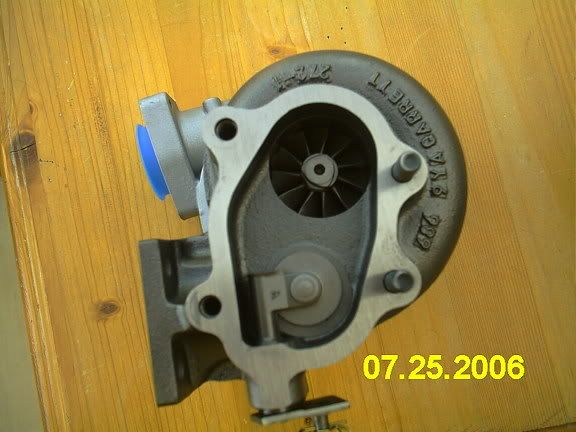

Bloody ell that,s pricey , i used Midland Turbo in Nottingham , £175 each for a full re-con with 1 years unlimited mileage warranty , we,re fitting them next week :dance: :dance: :dance:

Bloody ell that,s pricey , i used midland turbo in Nottingham , £175 each for a full re-con with 1 years unlimited mileage warranty , we,re fitting them next week :dance: :dance: :dance:
hopefully they will be ok!
This company,s been going for years , the workmanship looks superb ,as mentioned for a re,con it,s a fixed price of £175 +vat , one of mine needed a new compressor wheel due to partical damage and the other had a tiny amount of damage but they can re-face the edge of the blades as long as is will remain in tolerance and can be balanced correctly, the new compressor wheel was about an extra £55 , total price was IIRC £480 :dance: :dance:

they look superb i be in touch with them about mine i think
well i stand corrected, will wait ti see how they perform once Boldy has fitted them and run them a while :)
