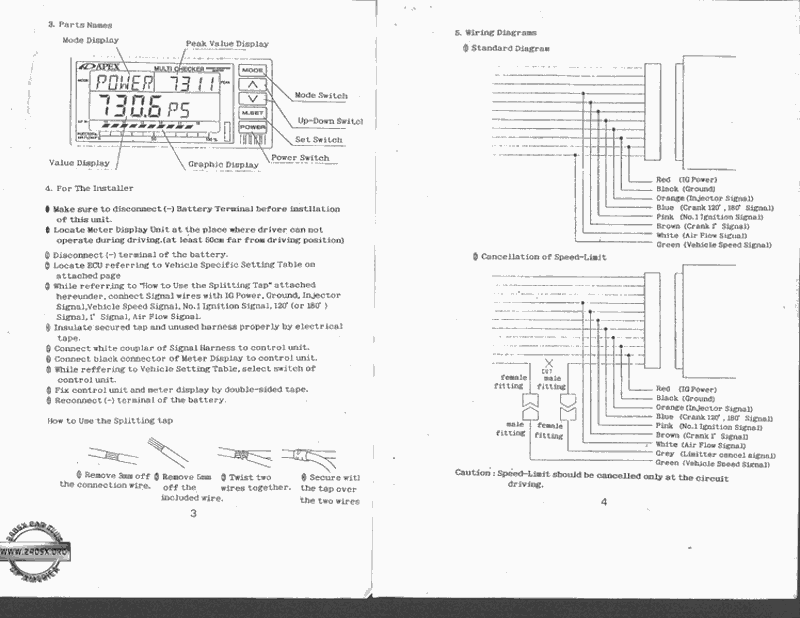

As above anybody got one, need to know what the pins do, trying to wire up a meter and after a few things, the diagrame i got with the meter don't look nothing like the ecu wiring i have, it's a jap spec auto 92 if that helps

That's the pic i have,

The pins i'm after are:
12v constant
Injector signal
no.1 ignition signal
Ground
Vehicle speed sensor
IG power
crank 180degree signal
crank 1 degree signal
airflow signal
if you could let me now what pin numbers they are that would be great.

Speed sensor is pin 53
AFM is 26 & 27 from the previous diagram
Ground is 50 and IG power is 59 from http://www.twinturbo.net/ttnettech/avcr/avcr.html
I'm sure I've seen the info on the crank sensor too, but I can't remember where.

Looking through there are 2 cam posistion reference signal 's would 1 be the crank 1 degree signal and the other the 180 degree signal?? if so takeit the first on would be 1 degree and the second 180 degree???

VG30 CAS has 1 deg and 120 deg outputs due to being a V ;)

ok did i identify the right pins?

Well still not quite sure, onthe crank angle sensors, so if you have any more help......
I *think* the reference signal is the 1 deg, and the position is the 120 deg. Not 100% sure on this though. 41 & 51 are the same and 42 & 52 are the same - the connections are bridged in the harness ;)
cheers mate your a star. however does this mean that the apeximultichecker i have will not work properly because it's after a 180 degree sensor input?

Found it!
41 & 51 is the 120 deg signal
42 & 52 is the 1 deg signal
EF&EC 107 in the service manual :)

but as my post above? will it work correctly?
Neil
And that's what i got sent with the checker... should learn to fooking read really!! tipical bloke thing i think!!! lol
