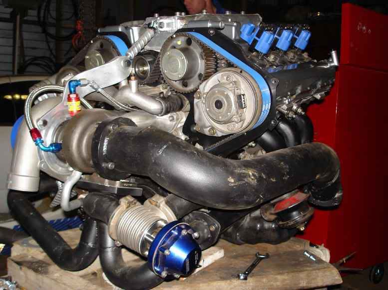

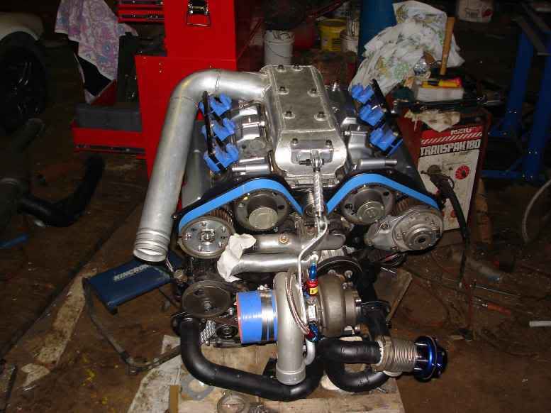

here's another single, but slightly different approach:
Although I won't mention the fact that it probably needs to have the melted timingbelt replaced after every run or so :D
