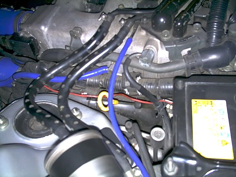

small pipe which one mate
http://www.300zx-mods.co.uk/images/P1001562.jpg
theres a pipe coming off the other intake pipe can i use that???
The one with the yellow dot (on top)-alternatively,trace this back and connect the the new ones in there place,doing the same job! :)

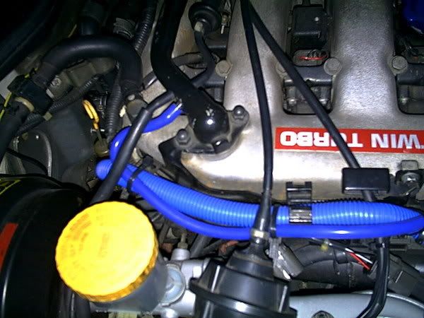

Here you go bud , i,ve also got Blitz fitted :dance: :dance:
