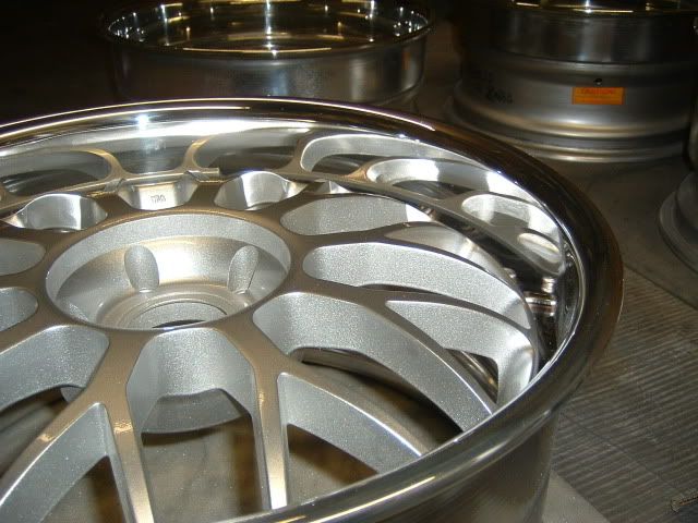

These are the rims I got for my Zed. As you can see, they've been badly curbed/lost their shine.
After being stripped and polished.
I got mine done by a chap up in Nottingham. Bit of a trek for me, but well worth it and he's very reasonable too.

No, the centres were done in a very high power silver. They do glow. Due to the mesh design on mine, it would have cost a fortune to get them polished. I considered it though.
