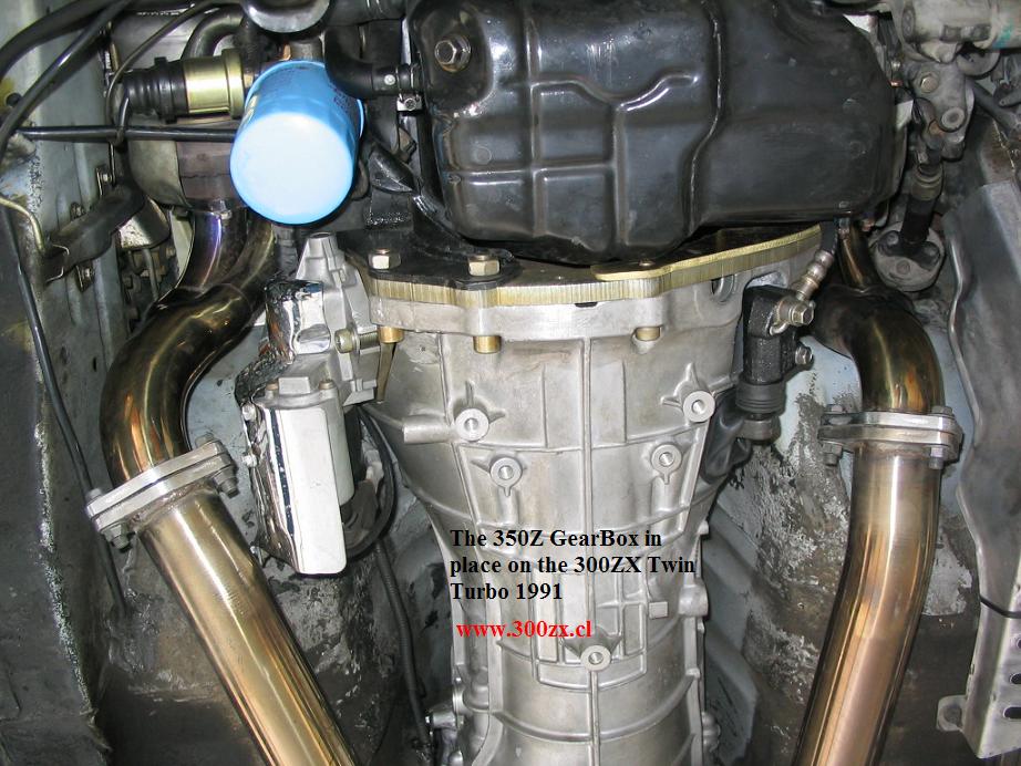

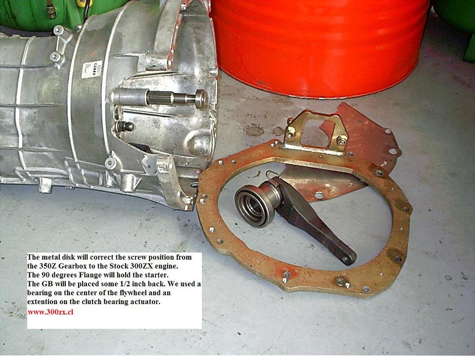

Has anyone looked into how much the adapter plate is for the 350 gearbox to 300 engine + starter motor adapter plate? I can't imagine it'll be cheap + you've got the cost of the box.
here's someone that actually did the conversion:
http://www.twinturbo.net/net/viewmsg.aspx?forum=general&msg_id=1393957
magic words: "nothing fits, absolutely nothing, we could have used a caterpillar tranny"
If somebody gets the drawing from the guy who did the conversion in the US, i will get the adaptor made up and include it in the price.
