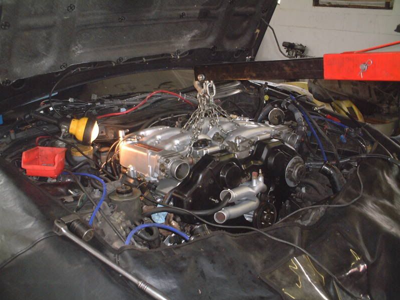

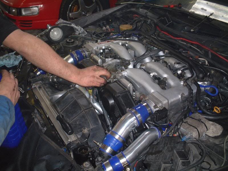

I had my engine rebuilt by Jimmer after melting #6 piston.
