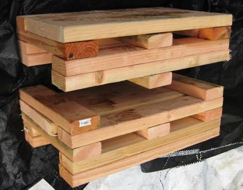

Just built a set of wood car ramps, low slope, 60" long, 10" rise.
5 pieces of 2" thick x 9" wide wood, each one 9" shorter than the one below it. Cost £33 in wood.

:cool: ,impressed,will try to do it myself next week:eek: i aint no chippy so it will look awfull i bet,John how did you fix them together,big long nails or bolts,cant make it out in pic fore certain;)
Tony,
Im no chippy either, thats why I had the timber merchant cut everything to size (the £33 for all the wood included cutting every piece to exact length.
For each ramp you will need: (2" thick x 9" wide boards)
1 piece 60" long
1 piece 51" long
1 piece 42" long
1 piece 33" long
1 piece 24" long
I used rough sawn lumber (planed would be nice but much more expensive) I nailed and glued them together. Some boards will be a bit warped probably, but dont worry, these ramps are sturdy as hell, even safer than jacks and axle stands, and much quicker.
But, they are heavy......each weighing about 80 lbs.
Regards
John

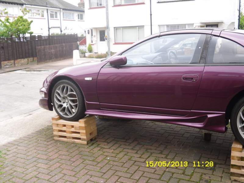

I tried something like this last week but didn't quite work out, my bumper is just too low.
Using the standard zx car jack and steel stands i can get my zx up enough so i can wiggle underneath the engine bay to do stuff. Its a good work out for the arms too lol. My zed is just 5" off the ground.
Yeah there is something reasuringly solid about wood when your under the car pushing and shuvving.
Nice one Dix might make some of these myself.
I have normal steel ramps with a wooden lower step, two screws in the end of the wood and they hook onto the lower rungs of the steel ramps, this is easy and it works but Id prefer the overall wooden jobby.
