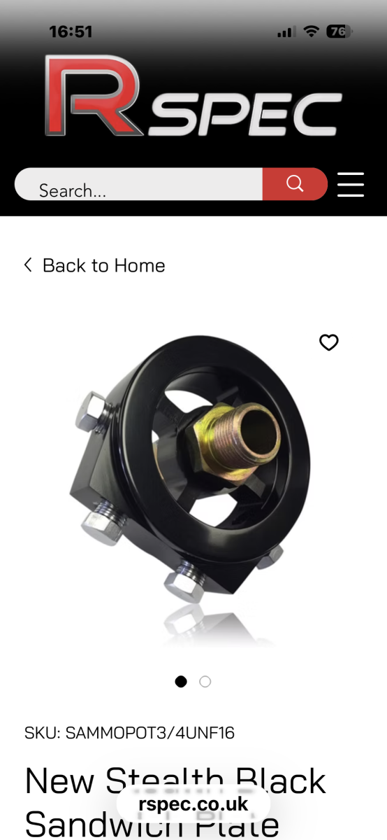

I have been using this for years and not had a problem.IMG_1679.pngS

Thats basically what i have, but due to the steering rack no matter what was you put it there isnt enough room.

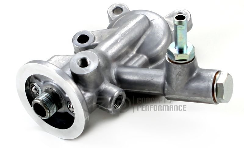

I just discovered that the oil tree at the end has a pressure release valve and does open to the cooler until a certain pressure.
That will explain why there isnt much oil in the cooler but the oil filter is near enough dry apart from what i pre filled it with.
Wow that’s crazy.
