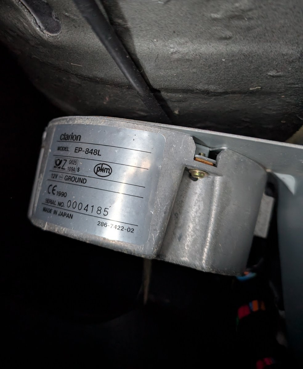

Having just seen your post about buying that lovely grey UK spec Zed, I'd say you'll have the OEM Clarion amplifier on the rear speakers, which most UK-spec cars came with.
So yes, if you want to upgrade your system without using the OEM amp, then you'd have to by pass it. As far as I know, you won't need a by-pass kit - you should just be able to re-wire the rear speakers. Which you'd no doubt be doing, when you install your after-market amp anyway!
If you decide to keep the OEM amp, then all you have to do is ensure that the amp has a live power feed from the new head unit, otherwise the rear speakers will not work! The "Nissan-to-ISO" adapter kit does not facilitate this (it didn't when I installed a new head unit), so I had to bridge the connection from another live feed, on the head unit side of the adapter. I think I used the electric aerial one....

RicharsS, where would the Clarion amp be situated?
I'd say you don't have the Bose set-up; and it looks like someone has already fitted after-market speakers in there. It's quite common, as the original 6x4 speakers will be past their best after 30 years - although they probably weren't that great in the first place!
Lee has posted a pic of the Clarion amp above - and an insight as to its location. I can't remember where it it in my Zed, I don't recall seeing it inside the speaker enclosures, I thought it was behind one of the rear boot panels, next to the suspension turrets. But I could be wrong 😉
6 minutes ago, JaiKai said:
My series 4 had the amp and it was located down where the ABS unit was to the right side.
Obviously not under the ABS cover but rather under the speaker side.
That sounds familiar Lee.... I would have seen it when I removed the trim, to replace the boot/fuel flap release cable.

I've test fitted the new head unit without the new amp connected. I've got sound to the front speakers but not the rear. There is a Clarion anp below the off-side speaker, will this be preventing sound to the rear?
There's also this connector down there, is this for the amp and speakers?

In short, yes, the clarion amp is preventing the rear speakers working. I had the same issue - it's because the after-market adaptors from Nissan to ISO do not provide for a power supply to the amp.
You can either re-wire your old speakers or, as I did, bridge the after-market adaptor leads to deliver a live feed to the amp connection. It's easy to trace the amp's power feed from your loom - then you just pick one of the live feeds from the new head unit cables and connect it to the amp feed wire in the car.
Worked for me - I kept the Clarion amp in place and it works fine 😉
That's a great help (I think).
So the Clarion amp has to receive power from the head unit for the rear speakers to work and the only way for them to work from another amp is to re-wire them?
