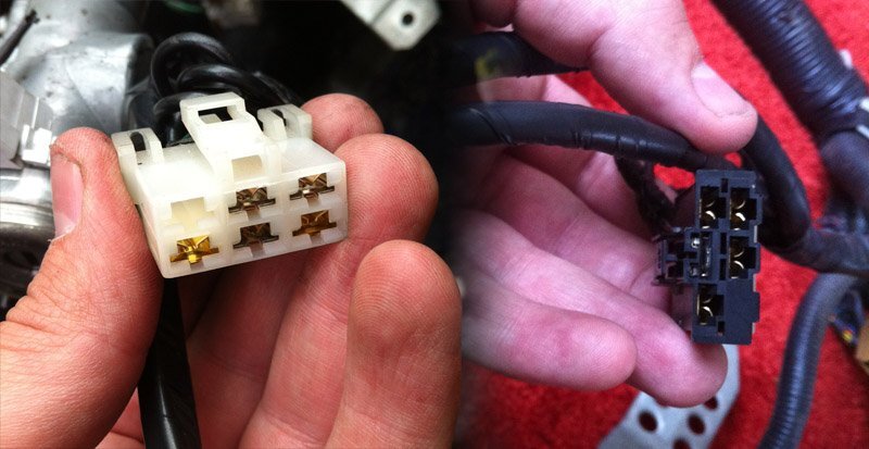

Time to strip the steering column cowl and see if you can disconnect the ignition.
Depending on the series there is a few designs of ignition, hopefully you get lucky and its just a plugin job
Series 1 i believe was hard soldered, below picture is from series 2 and 3/4, white plug is from a series 3/4 and the black was a series 2 that i assisted in breaking.
Start the zed pull the plug and see if it stays on.

Hi mate, mine is a 1990 and luck aint on my side atm so I bet its hard soldered , I'll take a look thanks mate

Hi, if it was ignition tho wouldn't me unplugging that plug at the back of the barrell kill it? Which it didn't? Cheers
Errrrr....*brain whirring*.....yes?
