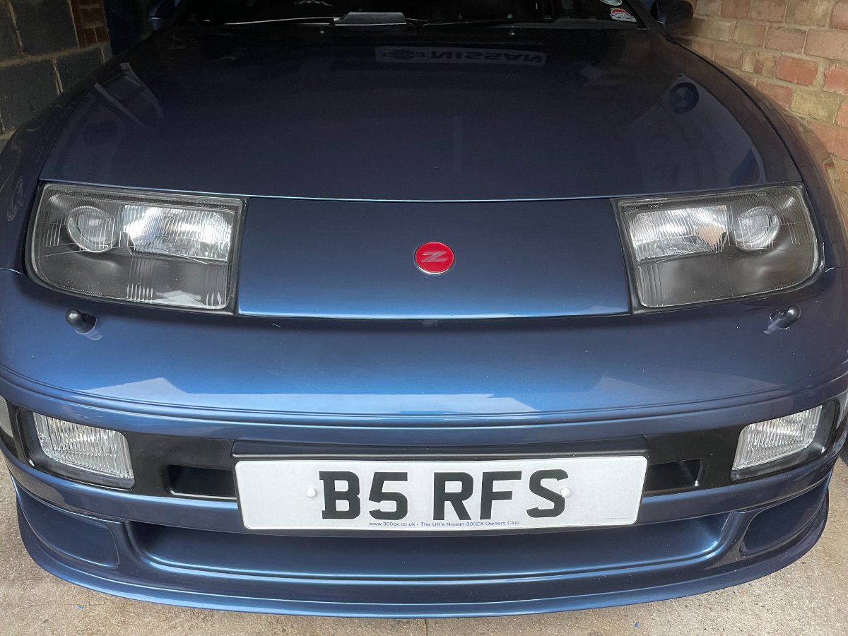

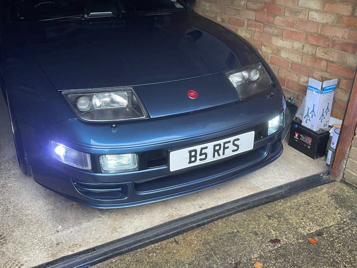

I recently purchased some brand-new J-spec fog lights from Luke, as I've never been 100% happy with the UK-spec side light/indicator split. And yesterday I fitted them....

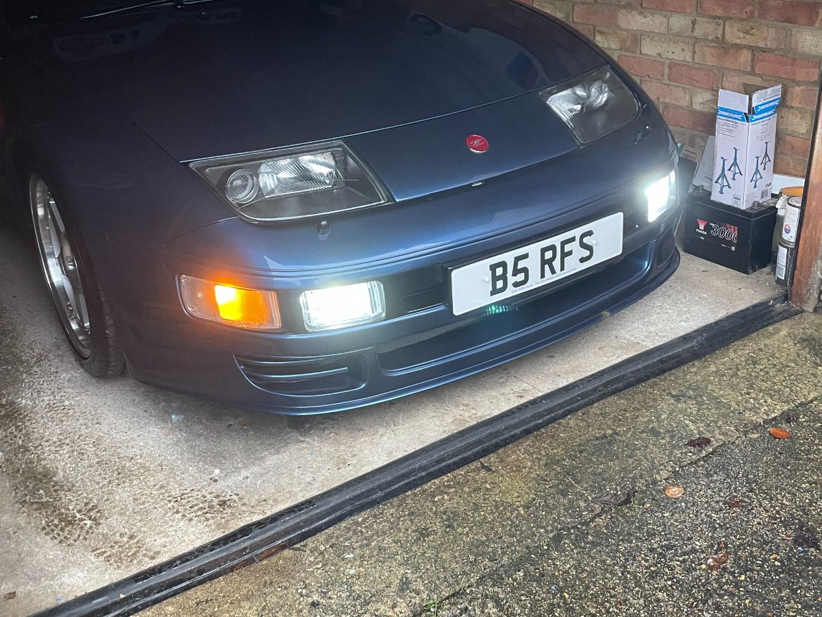

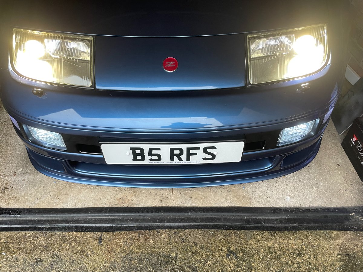

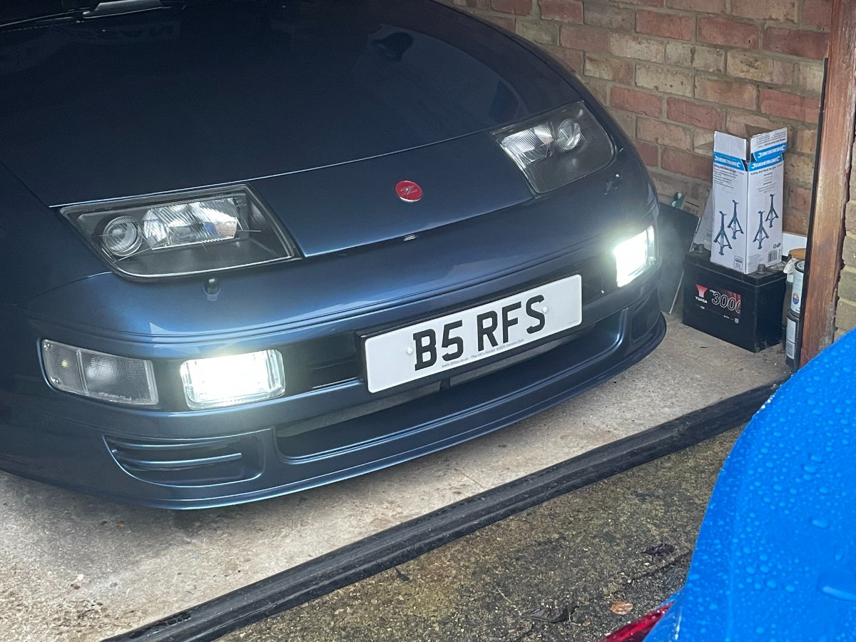

Although not for use as fog lights! I installed some H3 LED bulbs and rewired them for use as daytime running lights. I also replaced the side light bulbs with some bright-ish LEDs.
I then rewired my corner lights (which were the DRLs) to become the indicators. I think they make the front end look much nicer - a real improvement over the original look. Especially now that the whole lenses light up in either DRL or side-light mode.
